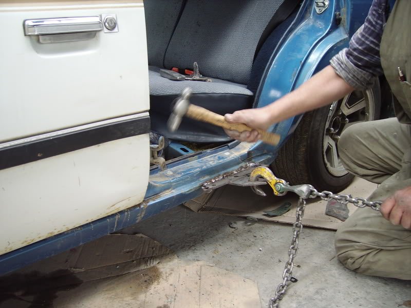

First job....get the bannana straight again...

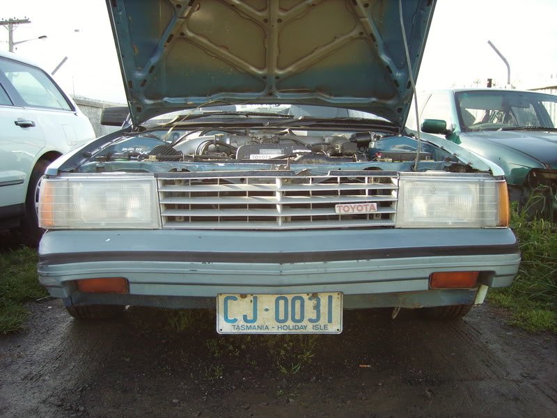

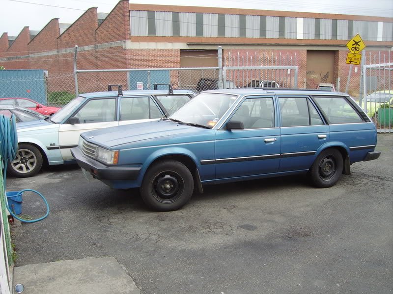

Bought this several weeks ago...I'm sure you can guess who from. Needing a bit of chassis and mechanical work to bring her back.
Couldn't help myself as I have always had a soft spot for the car, having worked on it and knowing its owner.

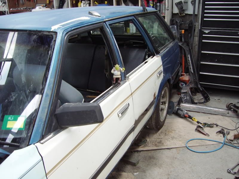

So far have straightened her back out on the chassis rack with straight panels, bumpers and missing trim from a matching colour st142 wagon.
Sourced another F series diff to replace the raped centre.
And have a xtreme button clutch to go in to again...replaced the raped jobbie currently struggling to hold any load atm.
Removed the half completed aircon, don't need that in TAS, and sorted the mismatched serpentine belt setup it had.
ST141 Wagon

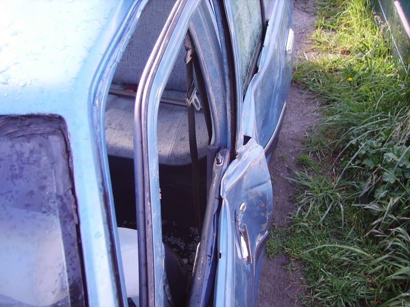

Originally only had doors from a sedan, so had to cut and shut the rear wagon frame onto the sedan door.
And swap the glass across as that is also different,
But then found out a friend had bought an st142 wagon for the mechanical, so I bought the shell, which made things easy.

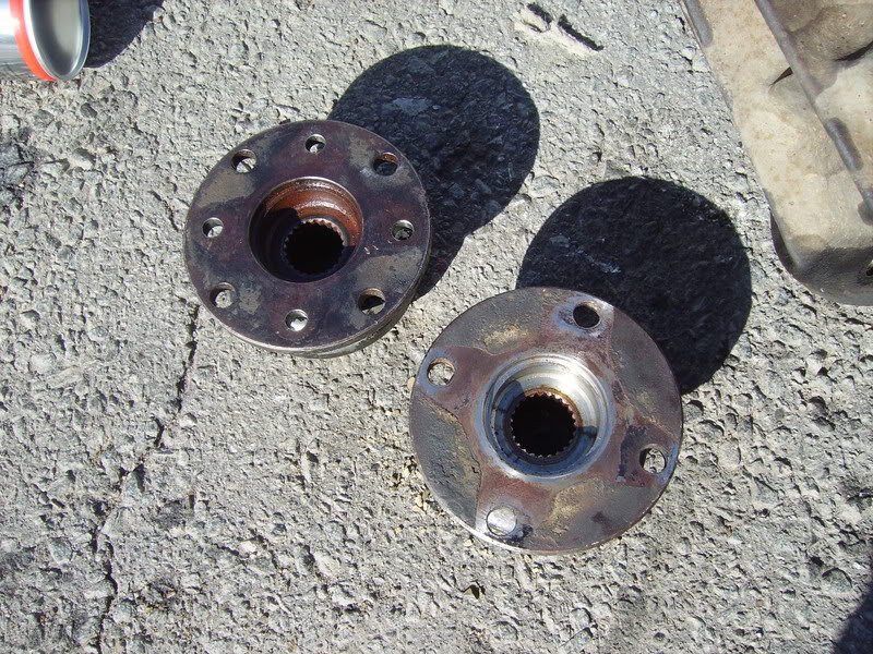

Ok second try with the correct centre...
Swapped the flanges across to the one redrilled for the corona shaft...
Big axles in these...I likey

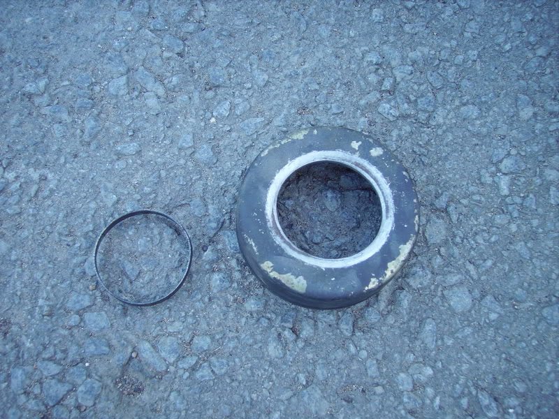

Also found the front slinger that is usually attached to the tail shaft had come away and was swinging around on the shaft, so pissed that off...
