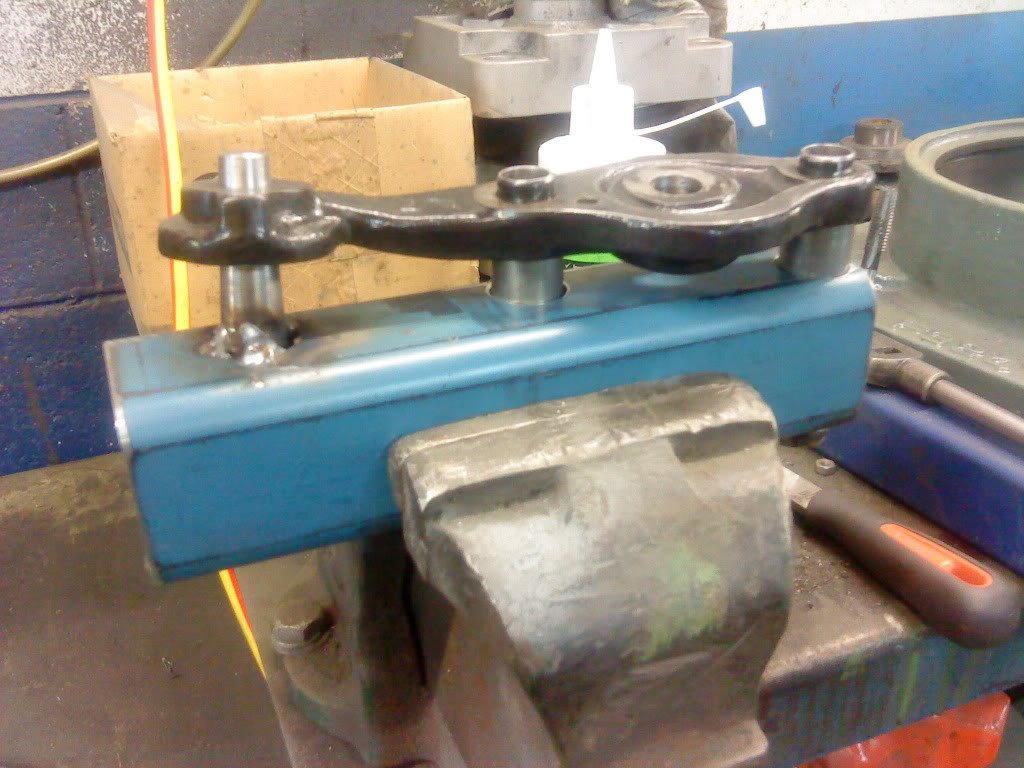

Wheels straight, could not even get the bolts in square to the strut enough to be able to bolt together. Other people who want to run the 86 arms with my setup bash the end of the LCA but I'm not real keen on that idea as it might make next balljoint change a pain in the arse.

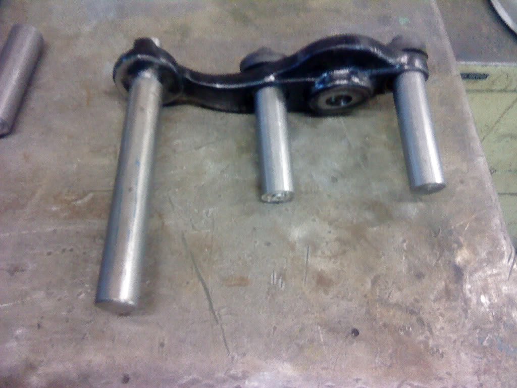

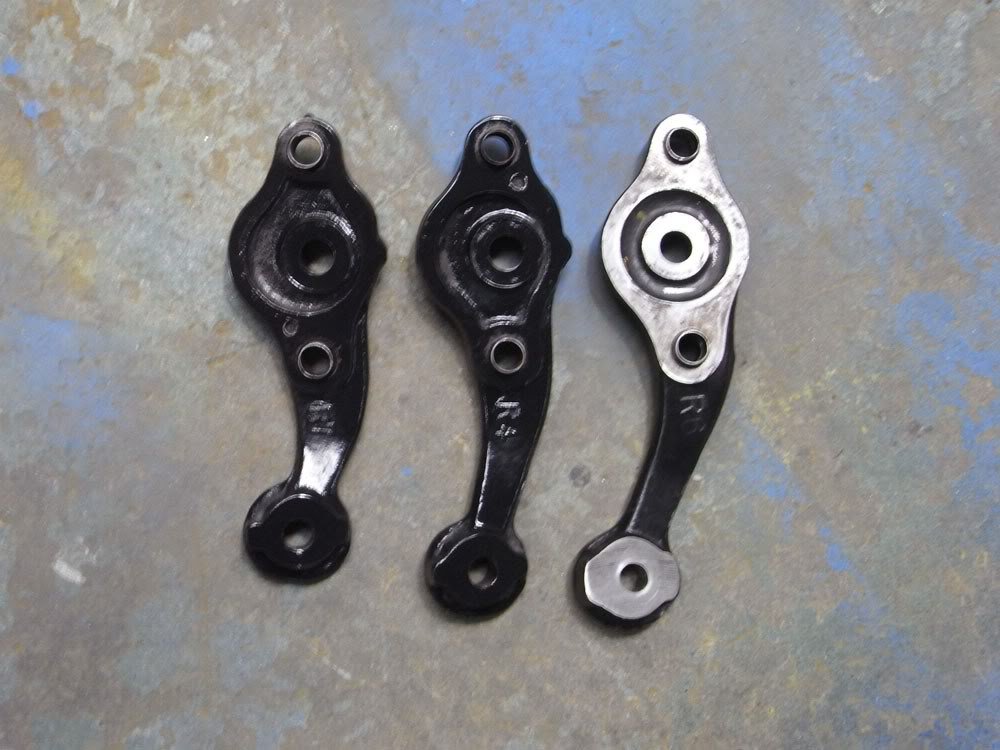

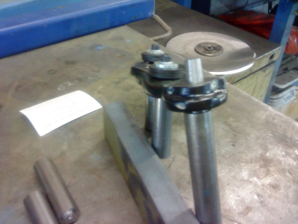

I'm thinking the solution to my problem is going to be making a jig from my AE86 PS arms and cutting / shutting a pair of XT130 or RA40 arms to suit said jig. Went to pick-a-part after work as their website had a 1980 Celica listed but sure enough the website was wrong and that car had been removed from yard, spewin'.
