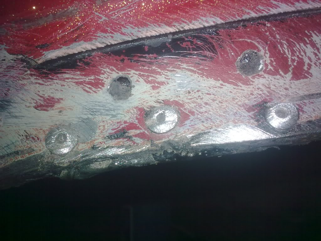

Once all the panels were properly welded up, they were ground back and roughly smoothed out with bog,.

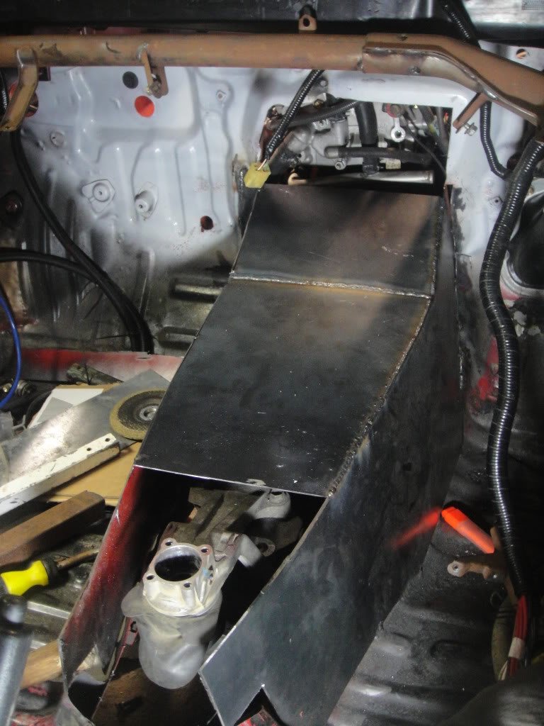

I was feeling a bit lazy and just brought some engine mounts from buddyparts. then i fabbed up a gearbox mount and started making the tunnel around it.
The engine sat really good in the bay. it was nice and far back.
After all the tunnel work was done the car was completely stripped back, sanded, and painted.

Does the shifter have to sit so high? The custom tunnel looks massive !!! How is it when your sitting in there?
Whats the rectangle hole for above the trans tunnel?

The tunnel really isn't too big, i will put a few more pics up in a sec, the shifter position is pretty good. the j160 has nice short throws.
the rectangle hole is there to make it a bit easier to do any work on the back of the engine.
I remember jay duca basically having to pull his motor out to change a hose back there.

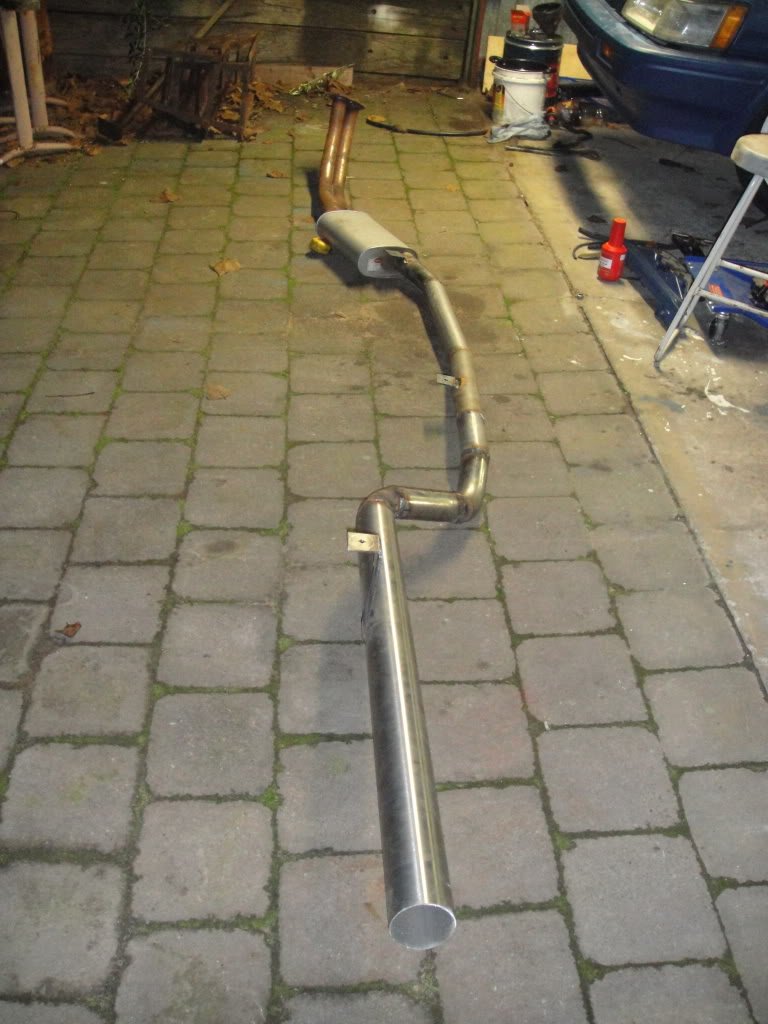

And an exhaust
