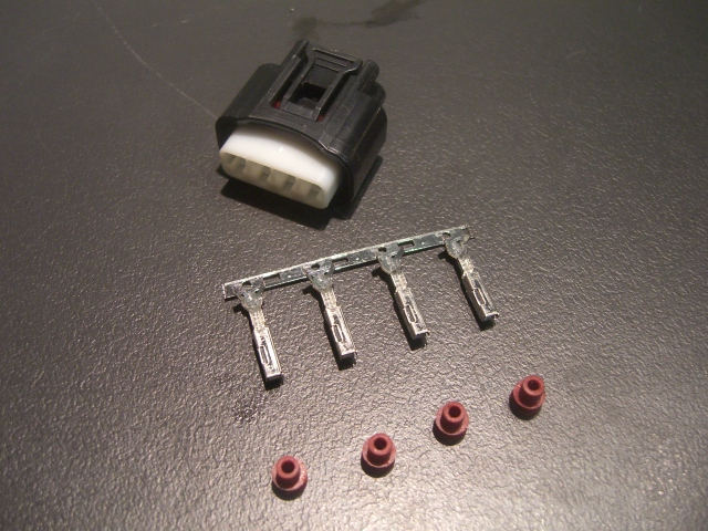

    As a note, also following up som something Sam asked. I have the following plug kits available for sale. These took a lot of hunting and the three components are from three different countries.
    The price is $15 per kit (per coilpack). Please let me kow if anyone needs them. I had to buy a few.

    Yeah I guess that's OK. All the coil packs have the same wiring. looking into the coil pack socket, or at the back (wiring side) of the connector with the clip at the top, the first pin is Earth, the second is trigger (IGT) the third is ignition feedback or confirmation (IGF) and the 4th is Ign 12V.
    The wiring changes a lot from model to model, but the pinouts remain the same.

    Some information I bumped into.
    Here are the Toyota part numbers for the 1ZZ-FE coil pack connectors:
    ! x Connector: 90980-11885
    Pins (x4): 82998-12440
    Toyota connector pins with 160mm wire - Toyota P/N 82998-12340 (USD $4.43 each)
    Pinout, looking into the coil connector moulding itself :
    Left to right : Ground - Trigger - Tach - 12V

    Quote Originally Posted by Anthony View Post
    Yeah I guess that's OK. All the coil packs have the same wiring. looking into the coil pack socket, [B]or at the back (wiring side) of the connector with the clip at the [/B]top, the first pin is Earth, the second is trigger (IGT) the third is ignition feedback or confirmation (IGF) and the 4th is Ign 12V.
    I am a bit confused with the wiring. Is it Earth, (IGT), (IGF), Ign 12V looking from the front (looking into the connector) with the clip at the top from left to right or looking from the back wiring side left to right? Can someone confirm the correct way to look at it.
