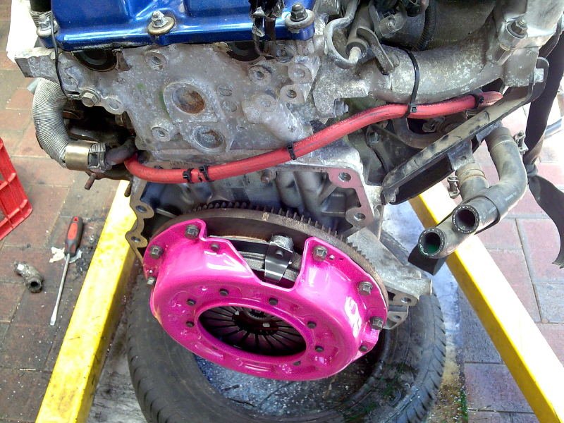

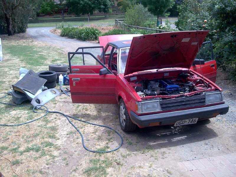

    The dirty looking S14 NA motor, installed and how it looked for a few months

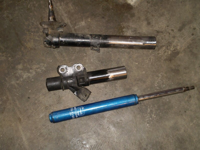

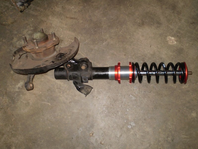

    Starting custom coilovers the ultimate Toyota and nissan interbreeding...

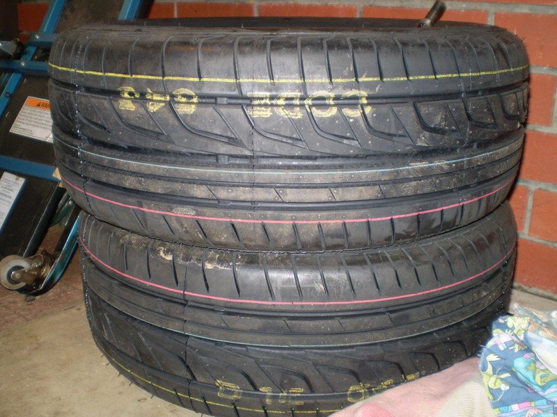

    RE001's are THE SHIT

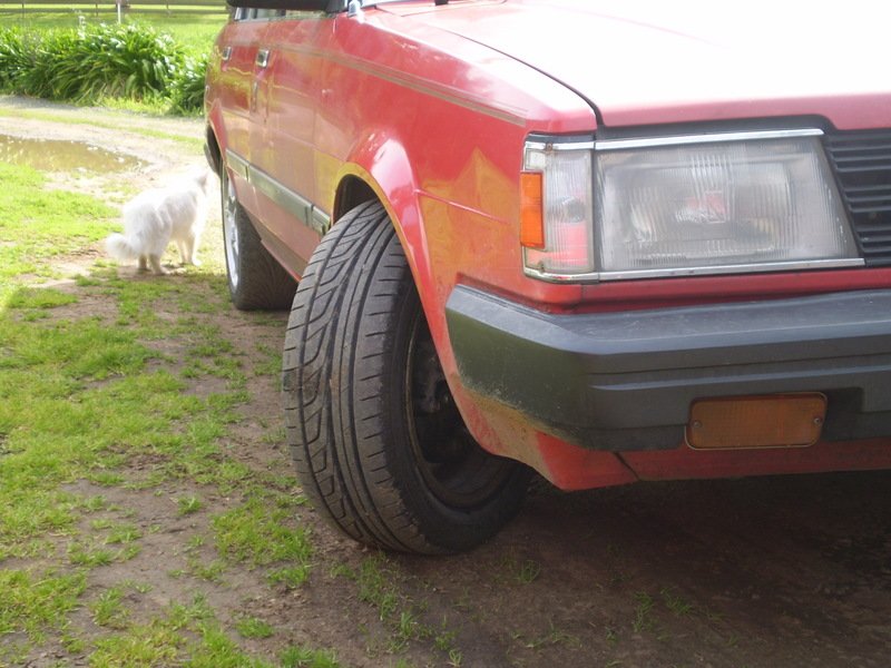

    had a decent amount of lock, will have a LOT more soon with modded knuckles tho

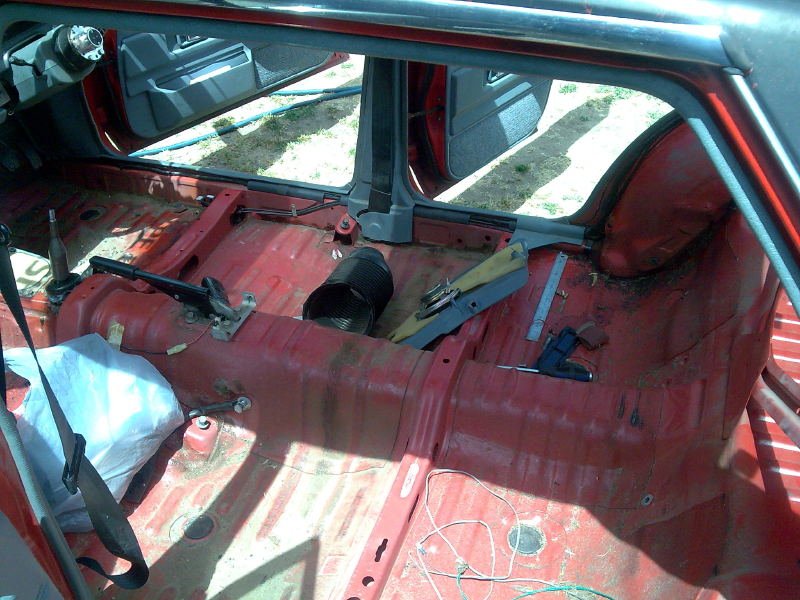

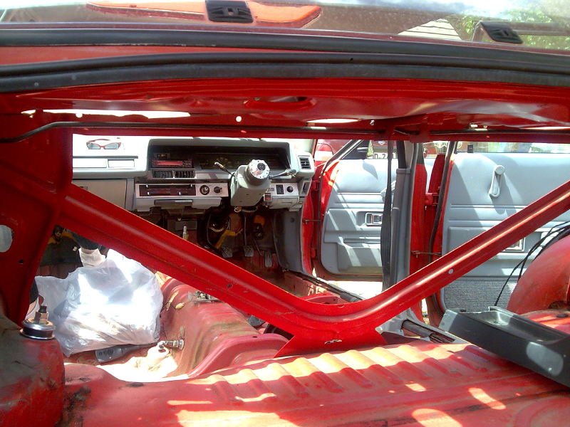

    Starting Stripping car....

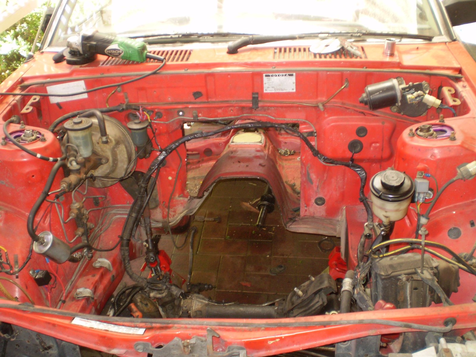

    Firewall mods being carried out, not yet finished
    Clutch and oil line on

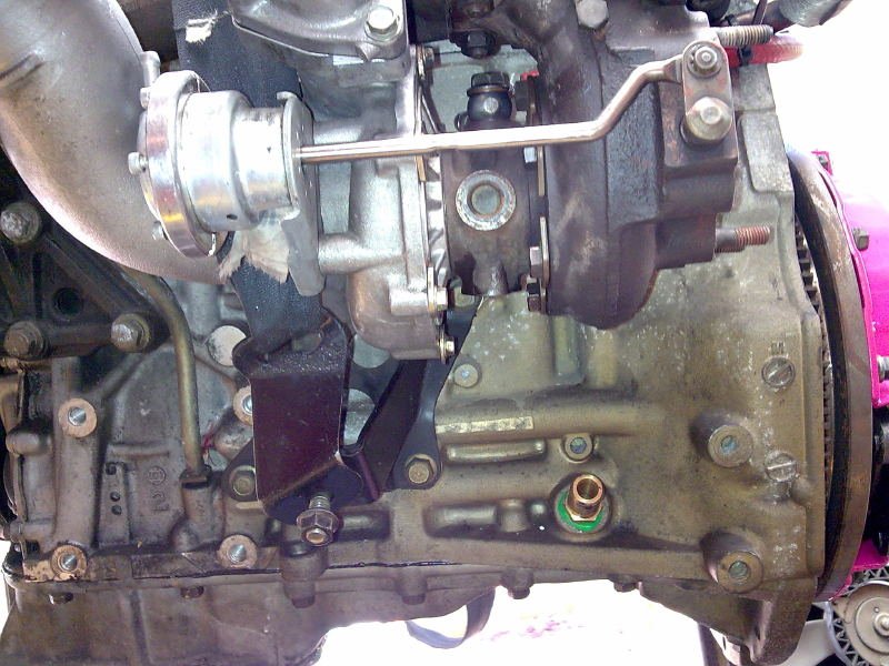

    Turbo on, oil return drilled and tapped, feed line on

    Been busy today, did the firewall and welded that up... took me forever cause the stupid gassless mig i was using kept overheating, not to mention the foam high up under the dash caught on fire... lol dutched the whole car out with smoke thats for sure... I was pretty certain i got rid of it all before i started but i must have missed some.
    heres the finished but un painted modded firewall.
    i'll prime and paint it later and motor back in tomorrow.
