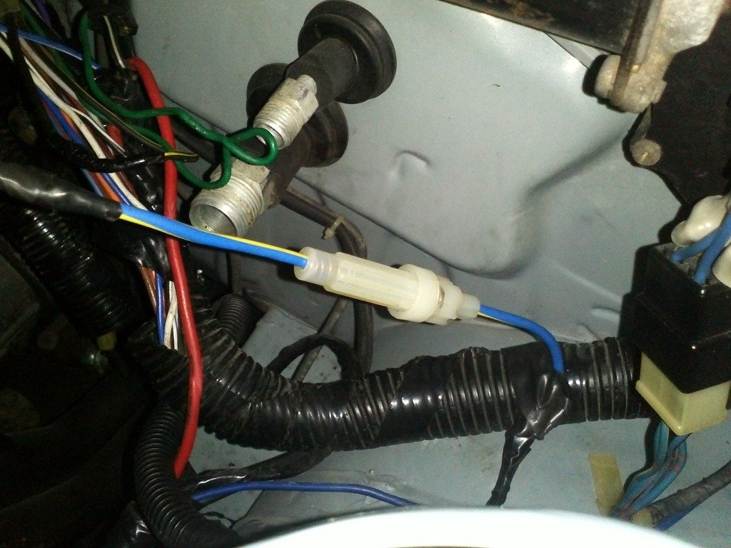

    I have been looking at the wiring and there is a blue/white wire leading from the fuel pump, under the car, to a single bullet-like fuse in the engine bay, through the firewall with the rest of the wires, to a relay attached by a bracket to the ecu.
    I have read up about the green/red wire that is connected to the relay which activates the relay for the fuel pump.
    From what I can see/test, the problem seems to be in the bullet-like fuse. The fuse is 20A and although it seems to not be broken, I don't believe it is carrying any current.

    Also with the photo of the fuse, I had to rewire another fuse in there (which worked for three starts).
    Hence the blue/yellow wiring.

    Where is your fuel pump located??? Not in the engine bay is it? There is no good reason to run that blue wire into the bay otherwise. By the looks of it they have cut into where the diag box sits and ran it back from there..

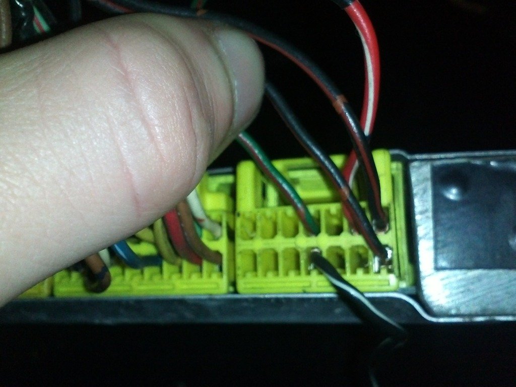

    Looking at your ecu wires, one of the power inputs looks it could be loose, it might just be the type of connector that has been used though but this wouldn't help your problem. Check it either way.

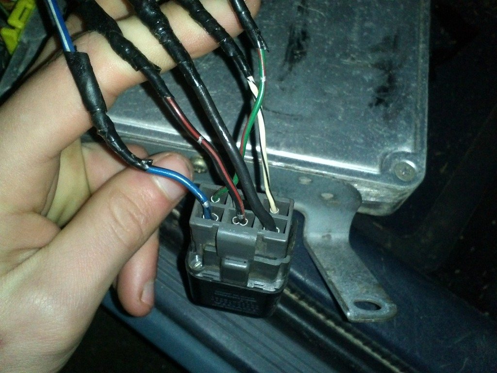

    With the picture of the relay
    You should have power when the ignition is on to the middle pin black / red wire. The white / black one should be hooked into a permanent solid earth. If the Black / Red wires is fused in factory configuration there is no fuse on the blue wire. The difficult thing in troubleshooting this is the ecu detects the engine isn't running then switches the green /red wire away from earth, hence taking power away from the fuel pump.
    If you are stuck on the side of the road and powering the fuel pump is the problem, check by disconnecting your ecu plug and earthing out the green / red wire directly and measure the power at the pump or listen for it if it is loud enough. To get the fuel pump running join the middle back / red wires to the blue one to get you home.
    Run a diagnostic check to grab any codes for peace of mind too.
    EDIT: When cranking the fuel pump should run, which is done by applying power to the thicker of the two wires on the edge.
    Pinouts / Factory Colours.
    Switched Earth (ecu/afm) - Green / Red
    Switched 12v (starter) - Black / White
    Output (Fuel Pump) - Blue / black
    High Amp Input (Output of EFI relay) - Black / Red
    Non Switched Earth - White / Black

    Hmm ok.. the black/white wire from the relay becomes a brown wire and goes with all the other wires up to the engine bay.. havent traced it any further yet.
    With the black/white wire underneath the green/red wire in the ECU, where is that meant to go?
    As it is just left hanging connected to nothing..

    That black/white wire that is taped up can be ignored as it is the A/C pin on the ecu...
    If the black/white wire joins up with the brown wires itd be earthed to the inlet manifold along with the other wires. Check the black/white wire has power when cranking, don't confuse this with the white/black earth wire

    Left over fuel/pressure in the rail. In a nut shell, trace the plug on the starter motor and splice in the thick black wire on the fuel circuit relay. If you get stuck, shoot me a pm and i'll talk you through it.
    And your wiring isn't as bad as some of them that i've seen. A quick test form a quick jumper between the black / red wire and the black/white (could be plain black) wire (bottom right corner of your pic) and see if your fuel pump runs and try starting it.
