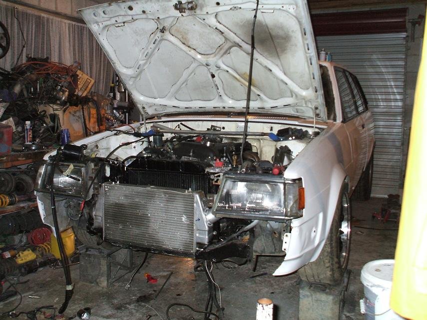

    Hey guys im new member round here...
    i thought i should post up a build thread for one of my cars, a 2dr ke70 van now sporting a sr20det
    was 4k when i got it... soon became 4kturbo with vf10 and suckthro SU, learnt the lesson about rubber seals in turbos and fuel LOL
    next it went to vf10 blow through SU, front mount vr4 cooler etc
    then it went to 5k (O dish) with vf10, SU at first then started playing with blow throu asain carb
    then rebuild it with molly rings, ported head, 272degree cam etc
    blew ALOT of diffs and axels and about 8 g/boxes, ended up with hilux 1420mm rear end(standard 1400) and a t40 box, this motor got tired from my bad tuning so slammed a 4k in there with hks manifold and vf10 with smaller front mount and shorter piping and went to a drift day, it didnt last long and melted a hole in no 3
    after that i wanted more power and friend had a written off s13 sitting on his lawn he had to get rid of so i gave him $1800 and sold about a $1000 worth of stuff off it and put rest in my wagon
    i could keep writing all day but don't have the time

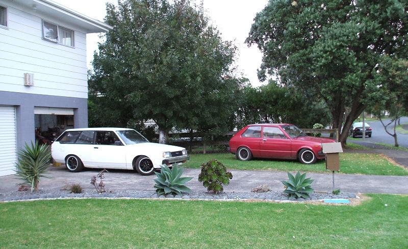

    my old daily starlet \/

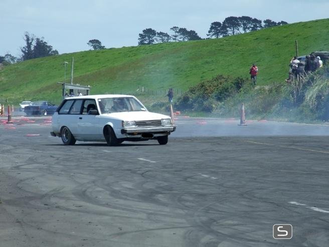

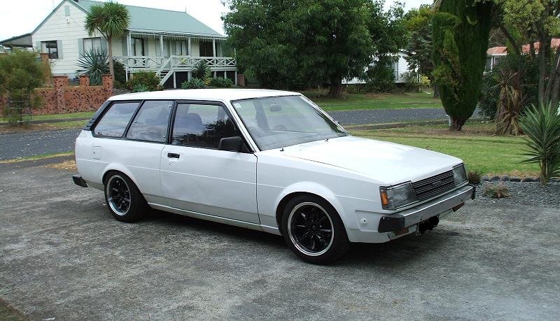

    Yes!
    This is rad. Good work!
    Flat front and no rear bar = Aswsome!
    What suspension work has been done?
    marvis.

    front is ae85/late ke70 front struts with 58mm removed from casing, trd ae92 inserts, 8kg springs, adj platforms, camber plates, rca's, rose-jointed caster arms, extra bar linking caster mounts, 25mm sway bar, and 22mm longer lower arms
    rear is reset leafs still running overload leaf and half a upside down leaf on top, 4wd van front shocks
    in the pic i was running power steering arms and 3mm lock spacers, have ditched them and putting togeather new setup of manual arms with quick rack and 25mm spacer, also ordered whiteline adjustable sway bar for rear, running none at the mo
    forgot to mention im in new zealand

    marvis it does have a rear bar.
    Our introduction - Click here
    Senior Member crackett's Avatar
    706
    Lol he knows that. He's saying ditch the rear bar and make it flat front.
    Anyways, looks boss as man. Plans for engine mods? Deffinitly looks like it would pull a mean skid.
