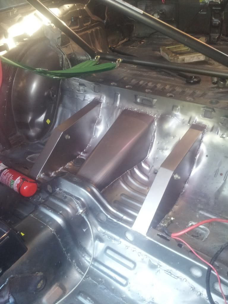

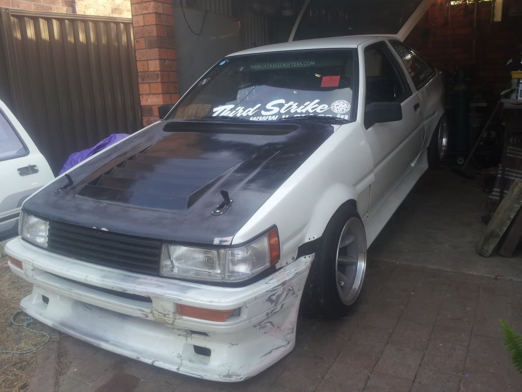

    just some random shots as of late
    been a little while since ive seen wheels on the ass end

    any reason you kept the bushes in the trailing arms?
    for the effort of equal length channels i'd put ball joints in there...
  4. #54
    cheaper and not as harsh, Im not a fan of rose/ball joints, the urethane bushes are quite solid but still have a certain amount of play which should make it seem little less harsh as opposed to the later, its just my opinion though, ball joints are still an option for later down the road
  5. #55
    why wouldnt you get adjustable arms? i know you can change the mounting point in the boxes but still?
    also with your rear over fenders, did you have to pull them out really wide to cover the wheels? did you put anything underneath them to hold them out while putting them on?
  6. #56
    Veteran lolwat's Avatar
    Crimebrook 2749
    3,971
    can all be adjusted with the box's yes not as much as adjustable arms, but enough to get what is needed, its a skid car not a time attack car
    flared the over fenders LOL!
  7. #57
    Glenn ke_70's Avatar
    Clay
    Barossa!
    5,311
    your worried about harshness in that car?
  8. #58
    Crimebrook 2749
    3,971
    its not that harsh aye, like deadset
  9. #59
    yeah, its quite comfy compared to others I've been in, i don't have a single ball joint on the car, just polyurethane bushes and @johl i don't see the need for adjustables, if you work out the angles and heights correctly it should all sit perfectly (which it does) with the solid arms, the pinion angle is dead level with my setup and also yeah i had to flare my flares lol, they still need some work but Im not overly fussed, love to change to some Dmax style overs eventually but for now these will be fine
