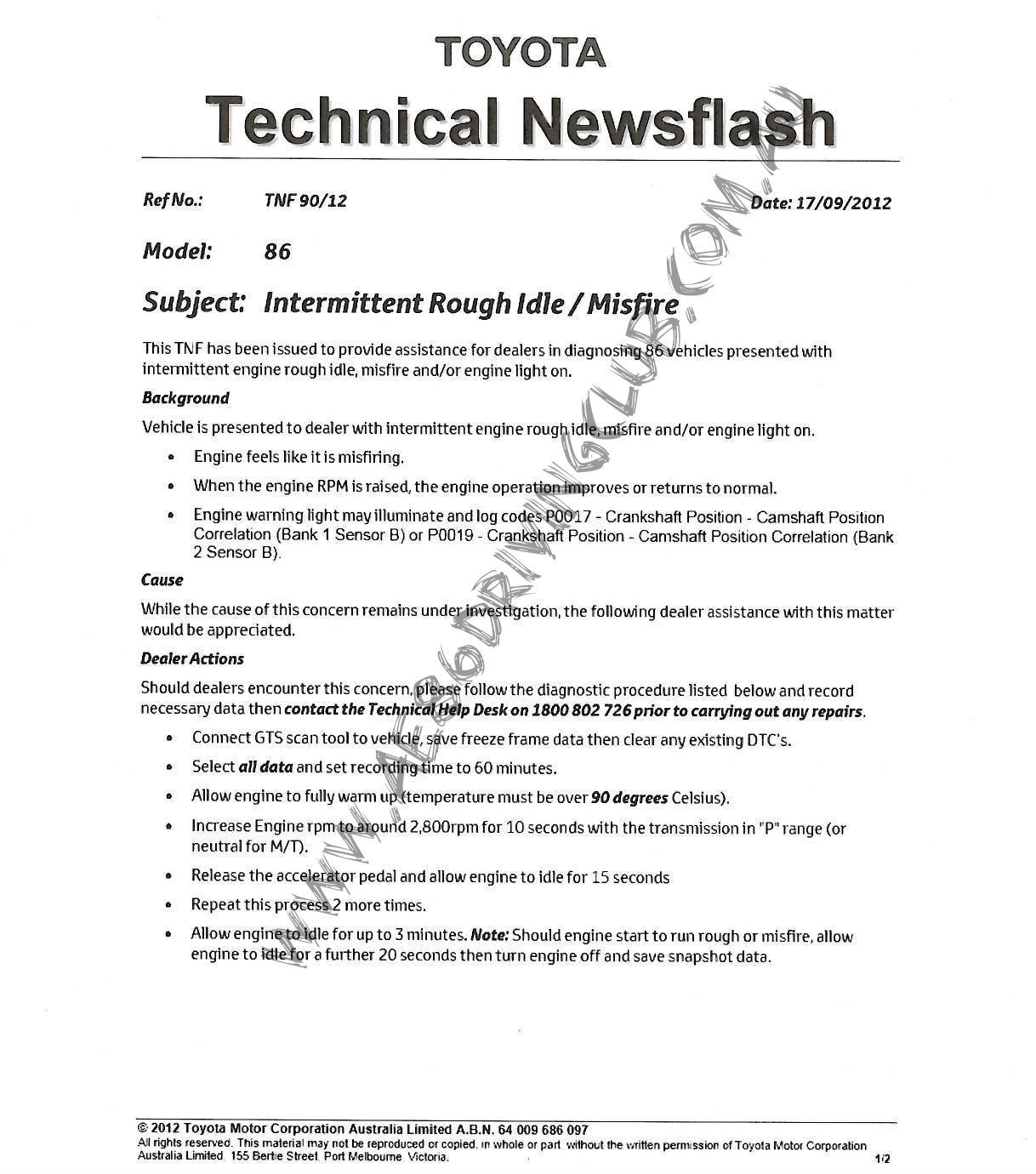

    Rumours have been surfacing that the source of the check engine light coming on and stalling of the 86 is related to the VVTI module.
    TMCA have yet to issue a recall notice and are investigating the issue , but it is anticipated that a recall notice will be issued in the coming days.

    here is what the guys in the USA are having done (stability warning light and check engine light come up - related to idle dip, rough operation even if no light does come up). CEL is related to cam positioning issues with some major cases of complete engine failure being reported. Most of the issues are in the USA due to it being the largest market, with some cars failing with less than 20miles on the odometer! Any BRZ or 86 (AT or MT) are affected.
    Got mine back today. Total of 12 days in the shop. Still waiting to hear on an extended warranty/compensation. Everything seems great so far. *Knock on wood*
    Cross posting this with the other thread just so it's referenced:
    Parts:
    SU003-00285 SPKT AY-CMS, EXH RH
    SU003-00096 VALVE AY-OIL CONT
    00295-00103 FIPG OIL PAN
    SU003-04522 UNIT-EGI CONTROL
    AR2 BRAKE CLNR
    00272-GTBC1-01 SUPER LONG LIFE COOLANT BLUE
    101 REMOVED TIMING COVER AND VVTI GEAR AND SENSOR WITH ECU PER TAS. AFTER INSTALLING GEAR AND SENSOR ROAD TESTED. OPERATING AS DESIGNED AT THIS TIME.
    Initial Diagnostic:
    101 CHECK ENG LIGHT 140021 7.00 CHECK CODES FOUND P0017 OPEN CASE WITH TAS TRYING TO GET THROUGH TO TAS 3 DAYS ON AND OFF HOLD TIME WROTE ON RO TAS REC BANK1 OCV SENSOR VVTI GEAR ECM ORING S TEAR SEALER TEAR DOWN AND INSTALL NEW PARTS ROAD TEST AND INSTALL ECU REROADTEST FOUDN NO COAD CLEAN ENG AND SHIP GET PART STAMP TECH 108
    I have seen a flow chart of the BRZ bulletin. It pretty much will swap the sensors from left to right to see if the issue is resloved (99% of them it seems dont work still - ie the problem still exists on the same bank as before). After replacing and swapping of all sensors, sprockets, solenoids etc; if still displaying CEL the ecu is replaced.... which seems to fix 99% of them. If issue still there it goes into an infinite loop of repairs (looking at the flow chart).

    Ecu reflash seems to be the fix in USA for these as of today. Some people have started receiving the update but not sure what results are like yet.
    Haven't seen anything on the Australian front yet...

    So there you go... Looks like Toyota needs more information before being able to fix it...
    Noooob
    Campbelltown
    5,229
    The official response is: “It does involve the variable valve timing, but it does not involve a mechanical repair,” Lyons said. He said the rough idle is the result of the ECU’s attempting to work around its detection of the anomaly, rather than what is triggering the fault code. The reflash “broadens the tolerance of detection [. . .] This is not a mileage-dependent condition. No replacement of the ECU is needed at any mileage to rectify the issue. The ECU re-flash is the fix. There is not a defect concerning the ECU.
