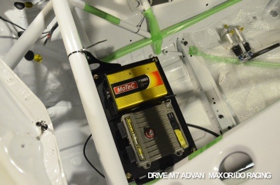

    Motec Ecu to keep the engine under control

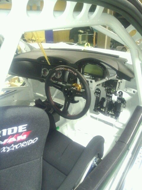

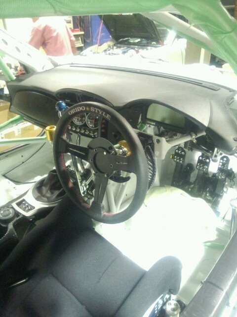

    Nice shot of the office.

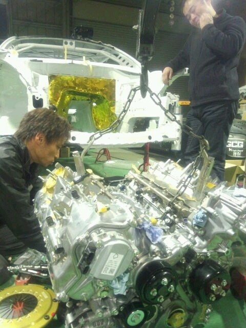

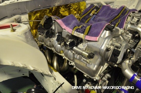

    The Lexus Engine has found its new home.
    Another shot of the office.

    But the engine specs for a stock 2UR-GSE is 4969cc , dual vvti / vte-ie on the intake cam
    89.5mm stroke with a 94mm bore
    311KW at the fly at 6600rpm
    505nm 373 ft lbf of torque at 5200rpm
    And also D4-S direct port injection.
    This being modified I would expect it to have a few more ponies than stock.
