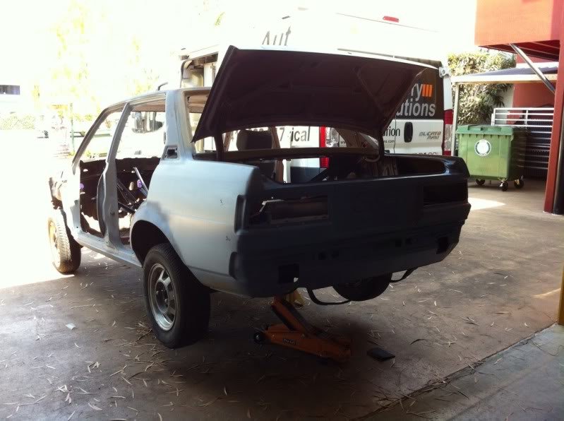

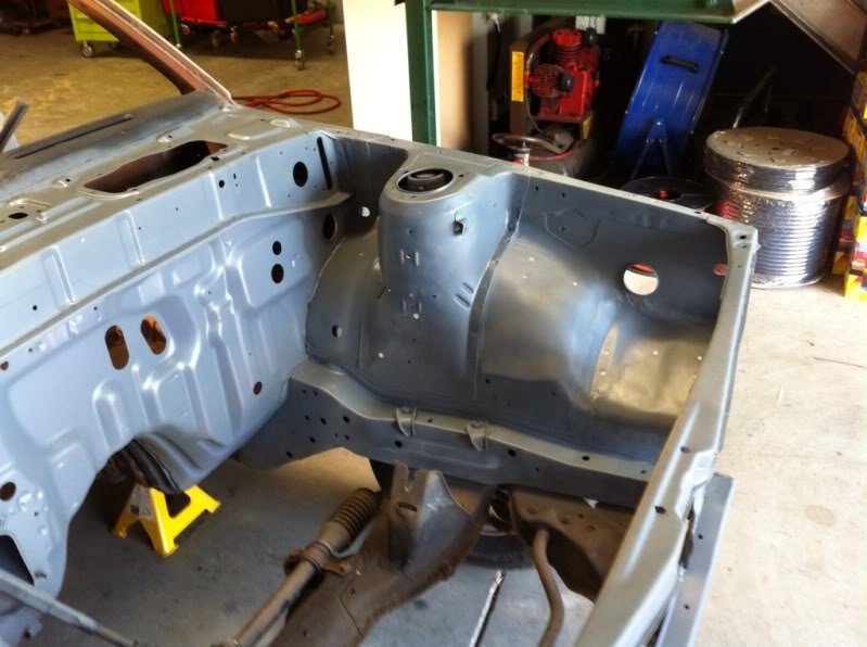

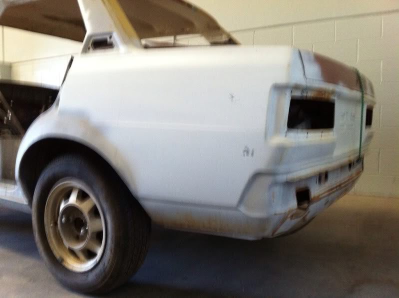

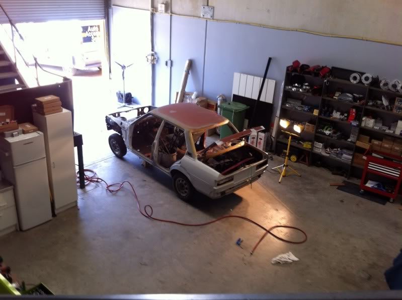

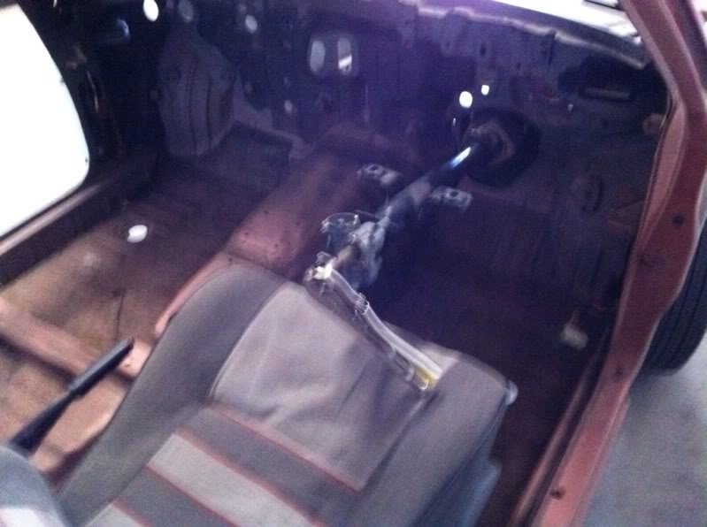

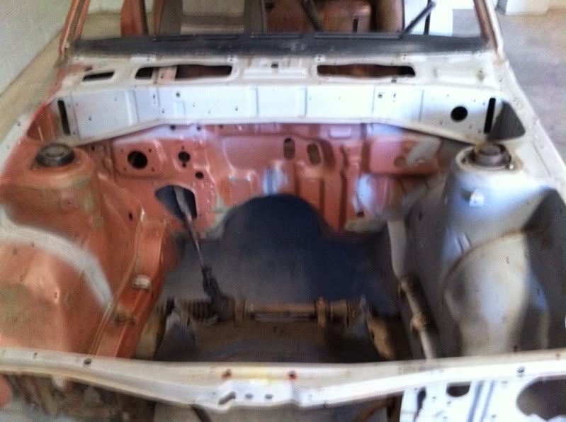

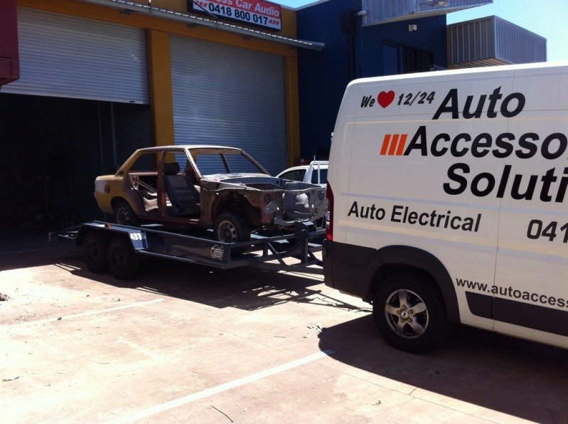

    Picked this up recently and have been tipping away at it...Might aswel throw it up here..

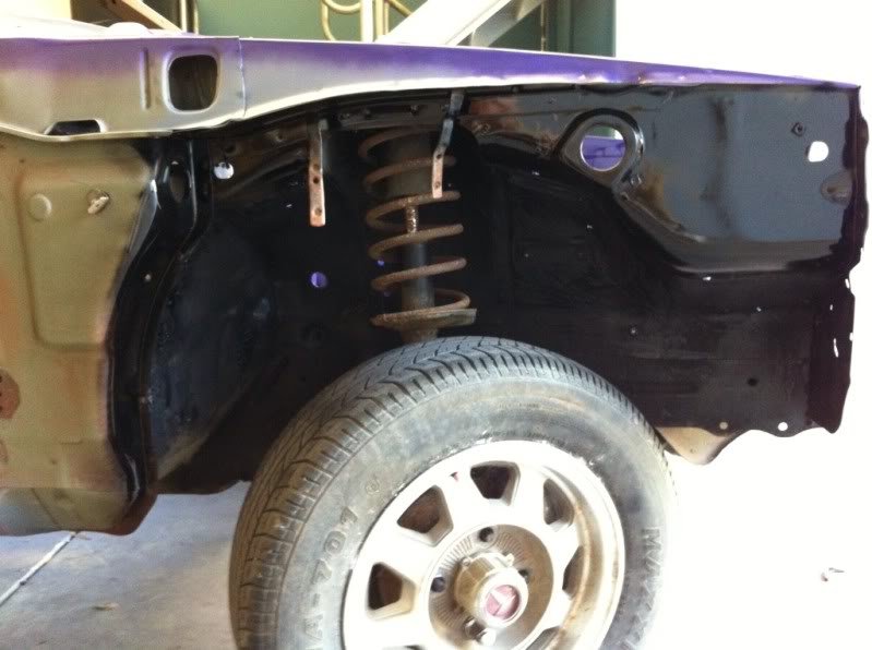

    Originally an auto AE71,nice clean shell with minimal rust issues..
    Painted the engine bay and got the body in a quick coat of primer...
    And clear coat on!

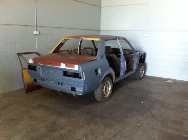

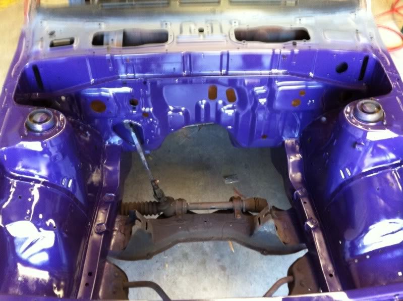

    Painted the tubs:
    And back in the corner... i DOnt get at it during the week as im working 12 hour days...:/

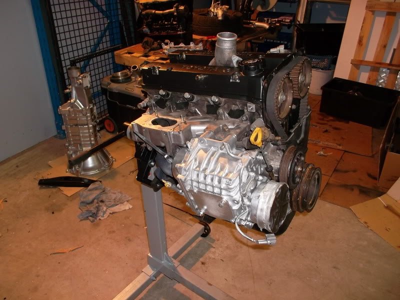

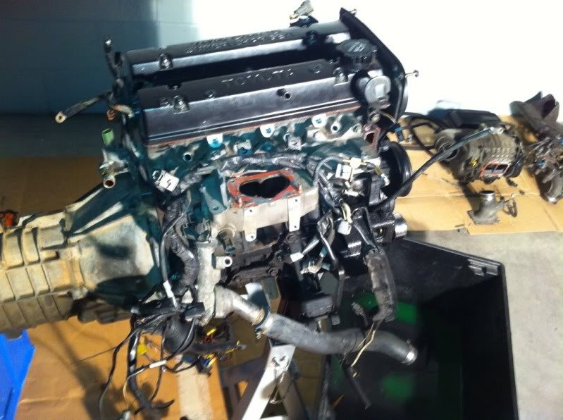

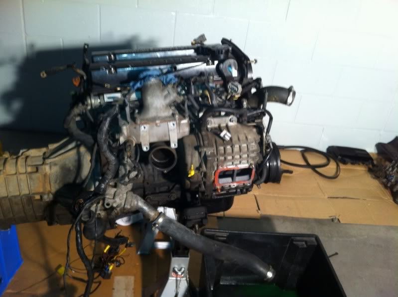

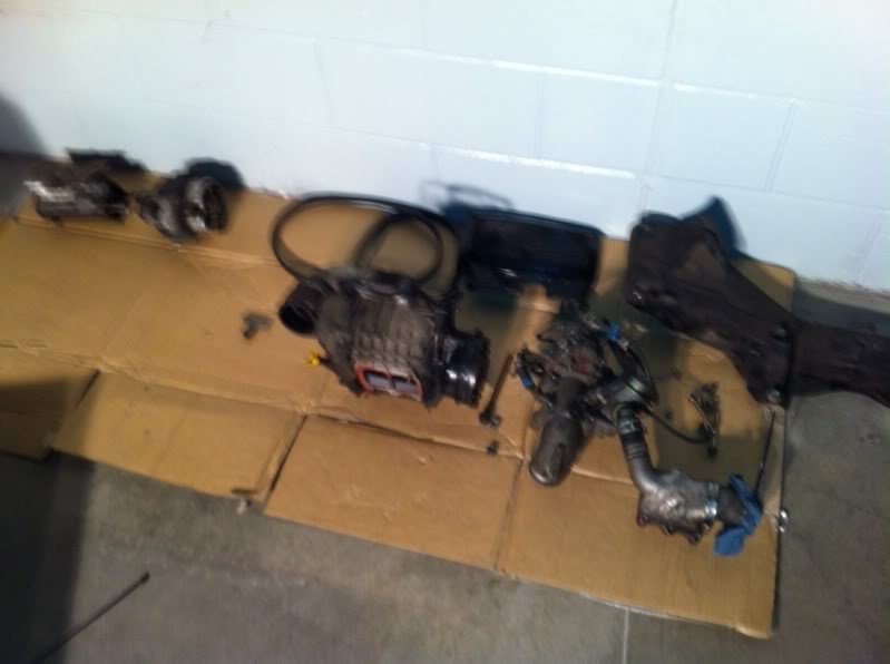

    Then picked this lot for it and stripped it down...
    Ae101 GZE
    Motor runs 12psi with a T3 pully and a 0.8mm TRD head gasket.
    HKS Mushroom filter
    Custom 1GGZE intercooler and piping.
    212mm silvertop flywheel and exedy heavy duty clutch
    ADM T50
    Cusco Solid Engine Mounts
    TRD Exhaust Mani.

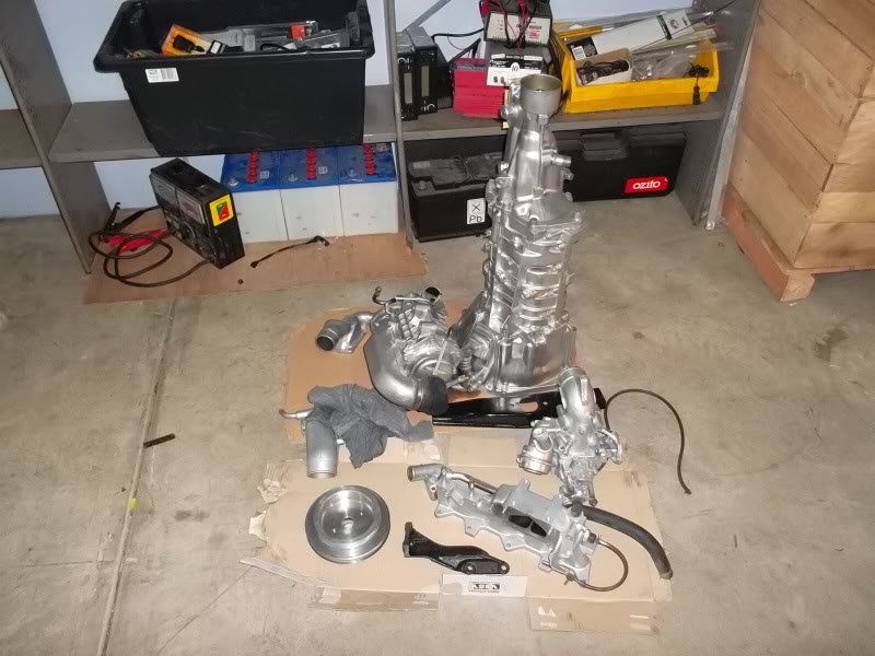

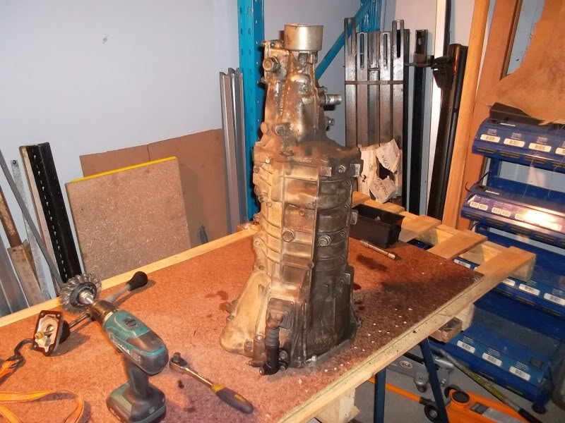

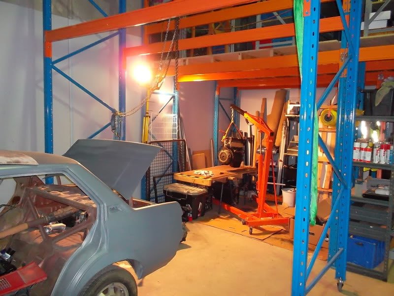

    Got my box cleaned up too...must get at it with a dremel in the hard places tomor and give it a lick,
    Before:
    After:

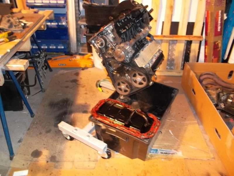

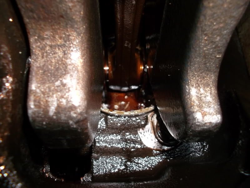

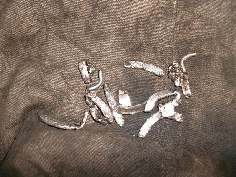

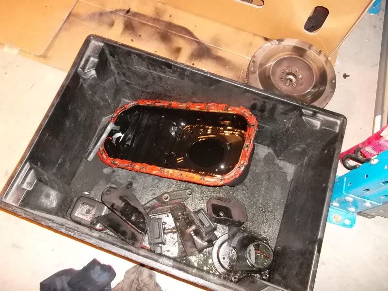

    Then i went to clean the sump to make a new gasket and heard a dreaded rattle...found these sitting in the bottom..
    Thrust washers fell out and done all the damage!
    Broken squirter...
    Chip outta the skirt:
    You can just make out the marks under the piston...

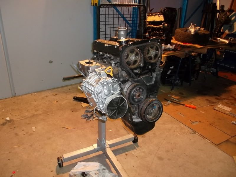

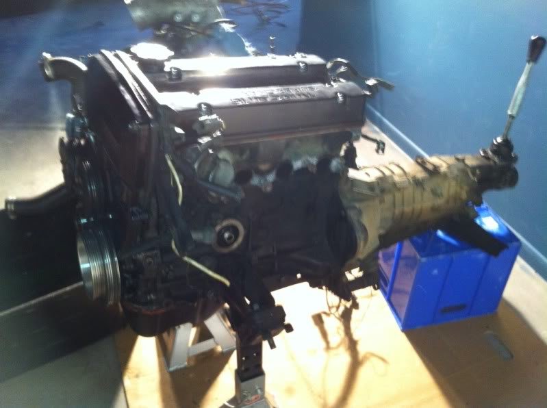

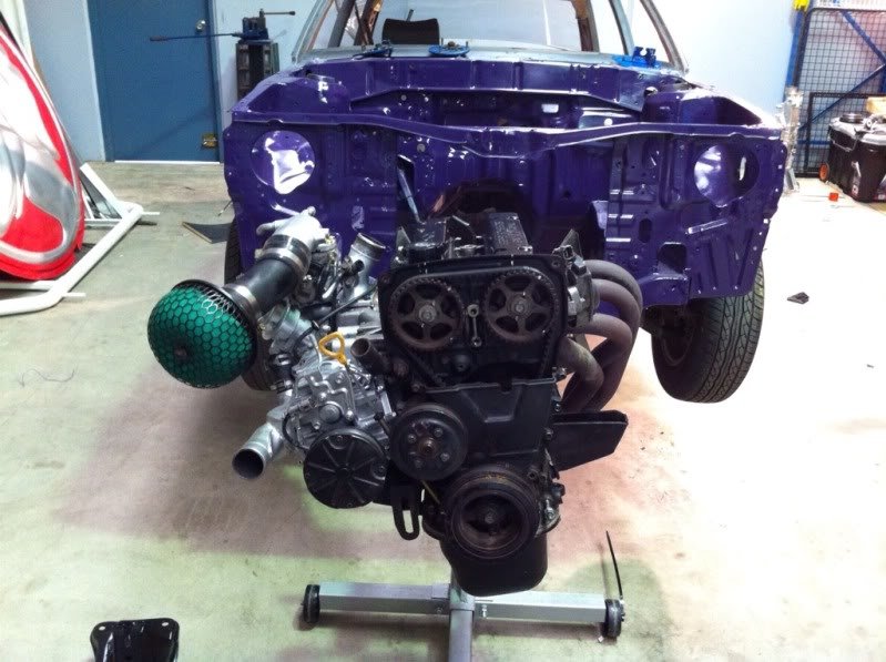

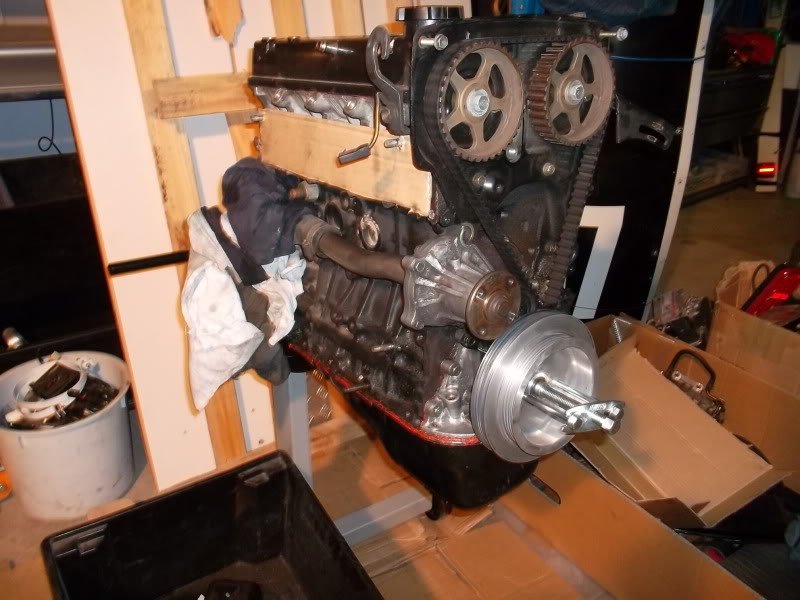

    Picked up another gze and assembled it..
    Made up a few gaskets...

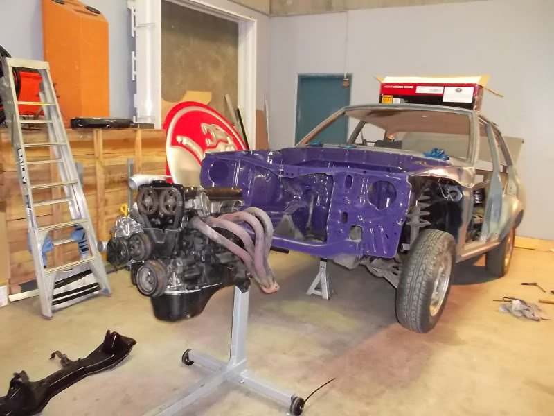

    Propped the car up to whack in the 86 crossmember..
  • #6
    Senior Member pt_y2k's Avatar
    Paul
    301

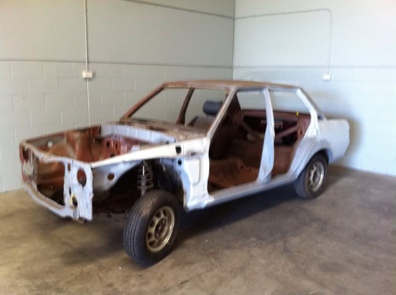

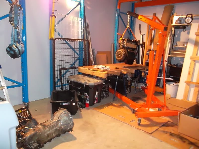

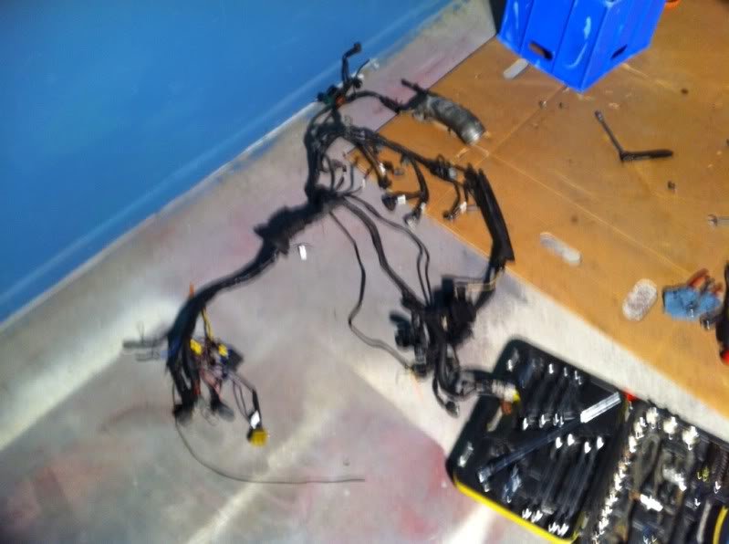

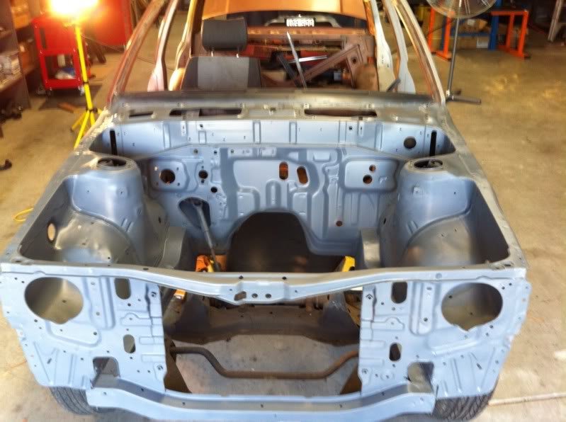

    Changed over the subframe....
    Whacked on the clutch and fly...
    And got this t3 tri brace of Spirited Drive..

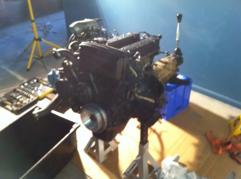

    Also stripped my damaged engine and took it to the local engine shop...he reckons block is good! So picked up a silvertop block for cheap,gonna pull the crank out and put it into my 16v block with new bearings,and gonna turbo it...
