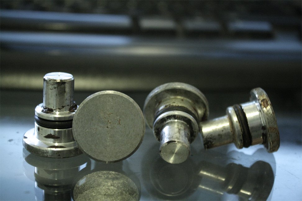

    I have some custom made plugs for the injector holes which you should easily be able to find someone that can machine some up for you, I have also heard of people using frost plugs, or even just using the fuel rail and injectors.

    reckon you can put a pic up of your plugs? or some dimensions as ive got a mate who can probably spin some up for me, also how do you stop em from popping out?

    Sure man I'll get some now. Gasket sealant or some sort of sealant that is compilable with fuel.
    EDIT:
    Here ya go

    So cause its on the vacuum side i guess it doesnt need much to hold em in place?

    I tapped the injector holes to M12 and put some cut down allen head bolts in them. The heads fitted nicely in the injector boss and you can always refit injectors if needed later.
