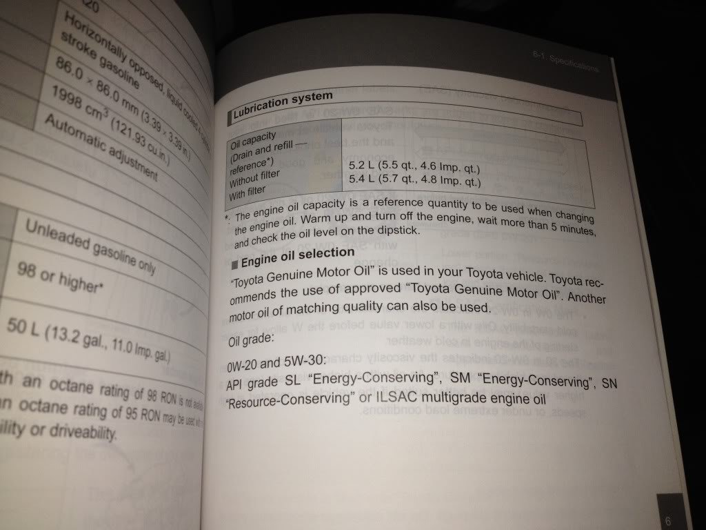

    Also oil for these must run what is on the cap which is 0W30 I think? it is $75 for a 4L bottle and need 5.5L. Had someone come in to change the oil and filter on his 86 for a first service but we only had 1 bottle of oil and no sump plug crush washer.
    Veteran Nikkojoe's Avatar
    Tom
    2,260
    Oil is 0w20 or 5w30 sn grade. Toyota sell 4L and subaru sell 5.5L for about $100

    Thats it, it was 0W20 or it said 5W30 for emergency's only.
    Tom
    2,260
    Owners manual does not state anywhere it's for emergency's only The subaru guy told me the same line too....
    Besides id rather have 5w30 when I do some light track work
