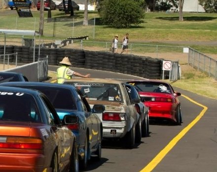

    Have been lurking for a while buying things, and with some help from metal fabricator little bro built this for doing skids. .
    1984 ke70 bought it out of some bushes for $500 stripped and 100% straight with just surface rust outside..
    Prover a year and a half changed basically everything.
    Stitch welded whole car, sealed up the rear and full weld in CAMS spec cage.
    Rad support and nudge bar.
    Tried to be simple.
    The rig, trusty 5L 98 caprice, built for towing and brake jobs even both together.
    Im so happy with it, skids a dream and 4th gear just makes me so happy..

    you car looks fat, love it!
  • #3
    Aug 2010
    Adrian
    South
    801
    Love the ratty body but then the awesome drive line lying beneath
