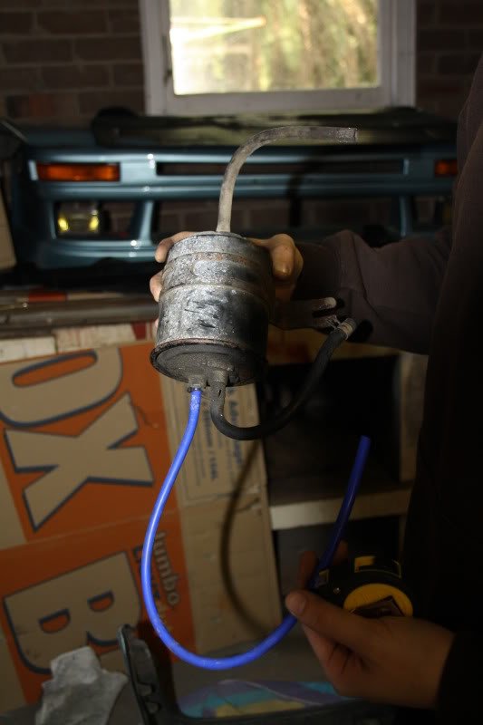

    So when I bought my sprinter it came with a random bucket of parts, some of which I knew what they were and some I have no idea. There are two in particular that I wanted to post up here and see if someone could help me out with identifying what they and where they go?

    Number 2 is just a charcoal canister, which is often removed

    And where does the charcoal canister normally connect up? Just want to check its been blocked off properly.

    that carbon canister was for the orignal 4ac engine i suspect. it doesnt even play a part in your 4age conversion (it should, but is very rarely connected)

    yellow dot, where charcoal canister should be.
