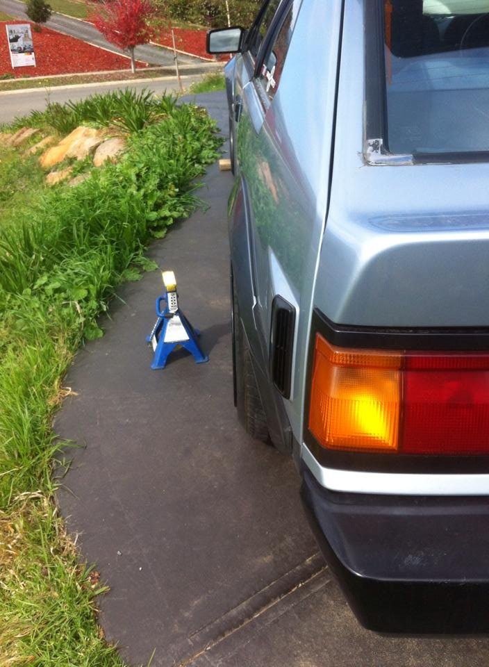

    Test fitted some 15x10-12 Performance Superlights with 225/50r15 tyres for 'research'.
    Notes:
    Tyres are too thin, could run 245s without rubbing.
    Track measured up at 1479mm.
    Max legal track is 1451mm.
    Rear camber accounts for 7mm each side.
    Legally should run 15x10 with +2 offset (borderline) to get within track.
    ~50mm clearance on the inside edge.
    Sitting just about perfect for my liking on the outside edge.
    Could fit 11"s and still be within track, assuming an appropriate offset.
