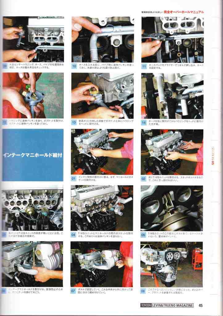

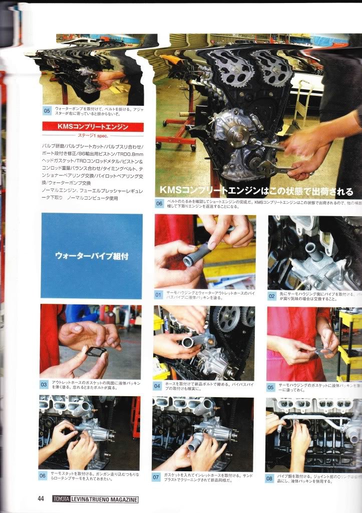

  10. #20
    Veteran slide86's Avatar
    Huw
    Hills
    3,526
    cooling system.
    here are some of the cooling system components of a RWD 4age setup.
    good if you are converting to rwd and need to see what parts are missing/what goes where.
    pretty self explanatory really.
    basically it shows the water pump and thermostat housing, the bypass hose and the rear outlet.
    second pic shows the details of the TVIS system and vacumn lines. inlet manifold is also shown being fitted.
