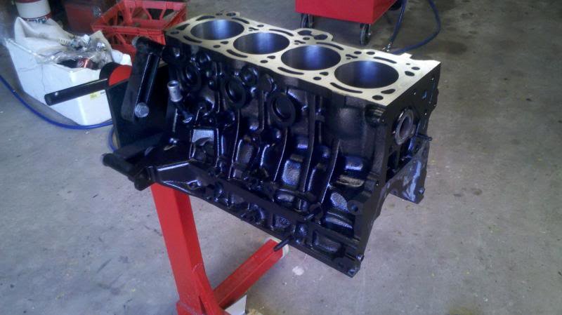

10/02/13 Well the staged build idea has gone out the window. I'm not wasting my time there, I'm just going to build the car once and build it right. Planned specs:
Engine:
- AE101 4A-GZE Engine
- Full rebuild including the following new genuine parts
- 0.5 Oversize Pistons (bore of doner engine was warn)
- Rod & Main Bearings
- Oil Pump
- Water Pump
- Full gasket and seal kit
- TRD Headgasket
- TRD Engine Mounts
- Cusco 175mm oversized harmonic balancer
Gearbox & Clutch:
- Rebuilt W58 with bearings and syncros
- Correct shifter position for E7 platform (More info here: !)
- Niteparts Bellhousing (The one, the only, best A-W bellhousing)
- AW11 225mm Flywheel
- Clutch undecided
Diff:
- Corona MX13 MKII F-series differential
- Fully rebuilt with new bearings and seals
- 4.556 Ratio Gearset
- TRD 2 Way LSD
Brakes:
- Rebuilt JDM AE86 front callipers
- ST141 Corona Rear disc brakes
Steering:
- Rebuilt AE86 Steering rack
- Power steering arms
- Lock spacer
Suspension:
- Greddy Type-S Coilovers
- Greddy EDC system
- Whiteline adjustable top trailing arms
Electricals:
- 1.4kw Genuine Denso Starter (More info here: )
- AW11 MR2 Genuine Rebuilt Denso Alternator and bracket
Interior:
- Driver & passenger Bride recliner
- Dash swapped for dark blue dash
- Full cage
- Drivers 4 Point harness
Exterior:
- 14 Inch Watanabes in gunmetal grey (whatever sizes I can find)
- Random hotwires & other 114.3 x 4 rims as skidders
- Series 1 T18 Tail lights
- Pin stripes and bump strips removed
I'll add more as I firm up plans and come up with more ideas.
Any comments or suggestions as to what I should go with, please do comment.
