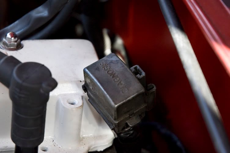

    and where is this diagnostic box?

    Veteran hao.'s Avatar
    Hao
    South Brisbane
    1,170
    It's a little grey plug thing that should be in your engine loom somewhere.
    It looks like this:
