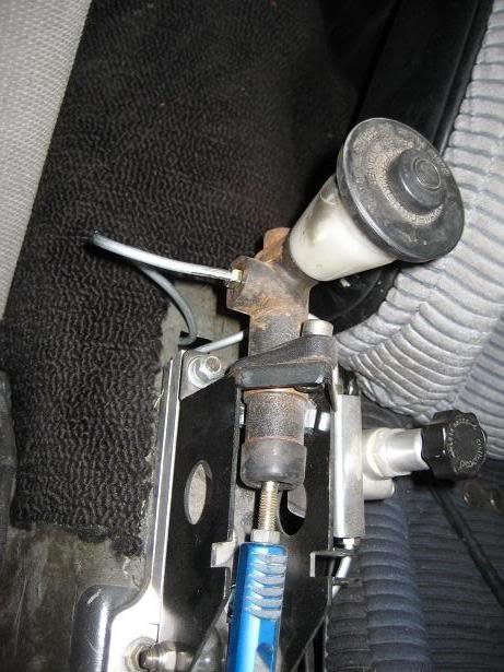

    Anyway update:

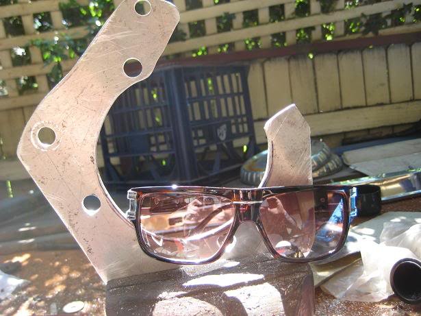

    Finally finished the Rear brake system. So the hydro handbrake works. Big thanks to Beau Small from Total Car Concepts/Westside Mufflers for using my shooty template and making me some sweet brackets.
    Pic of bracket and mandatory eye work wear for Club Charles
    All together

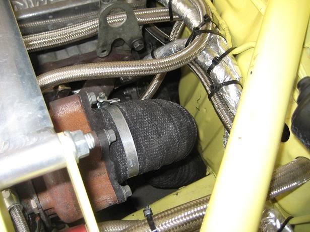

    Braided clutch line. this seemed to be a problem on the track day as the stock clutch line was heating up and causing shifting problems. So got a braided one made up from Pirtek. This one goes from the master under the engine following the steering rack and then onto the slave cylinder.
    Also to counter-act this problem i also got some Heat wrap for the damp pipe. (13meters worth) plus i chucked some heat proof paint over it hence the color

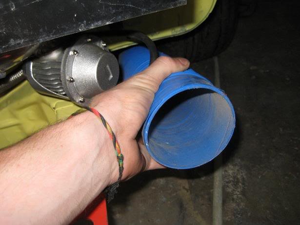

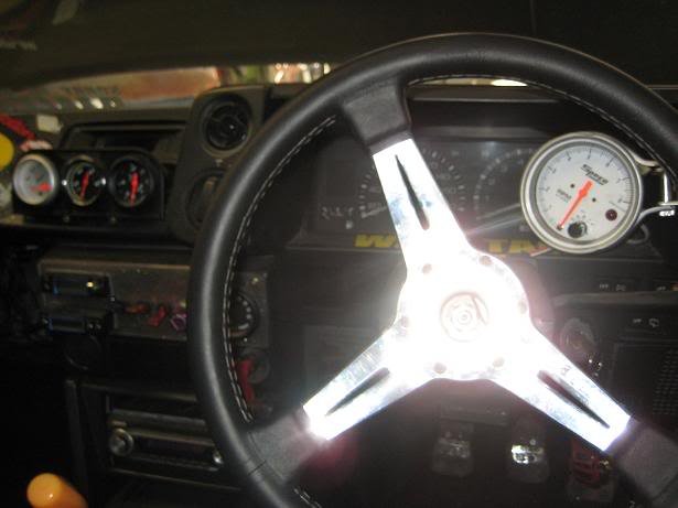

    Gauges finally in and working so driving want be so scary now.. Thanks B-Rad!

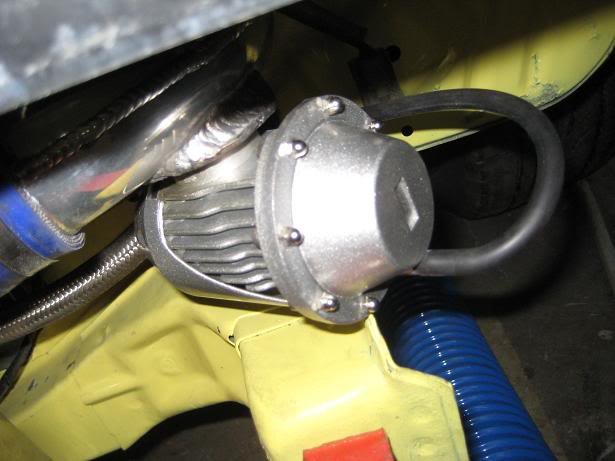

    BOV installed

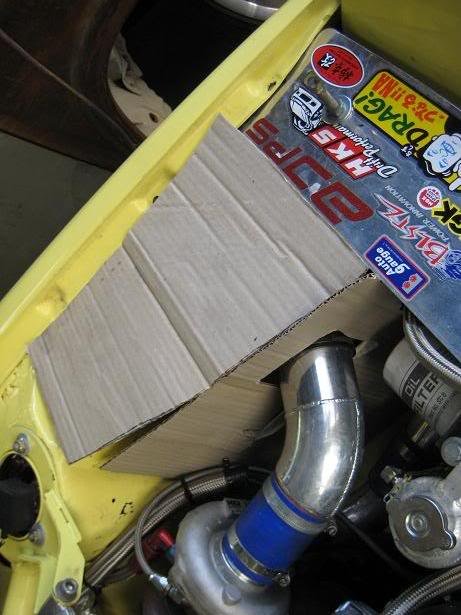

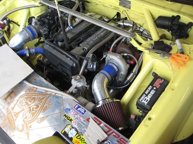

    Started making a air box for the pod that will have a direct cold air induction pipe directly into it. This should increase power by a lil bit
    Just an idea where the induction pipe comes out of..

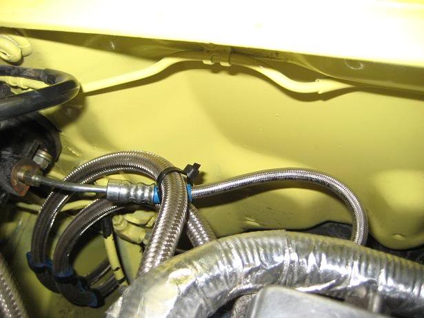

    General tidy up of the engine bay after oil leak and dirty and shizz! also redirect some lines and so on.
    Just a look at the handbrake set up with lines
