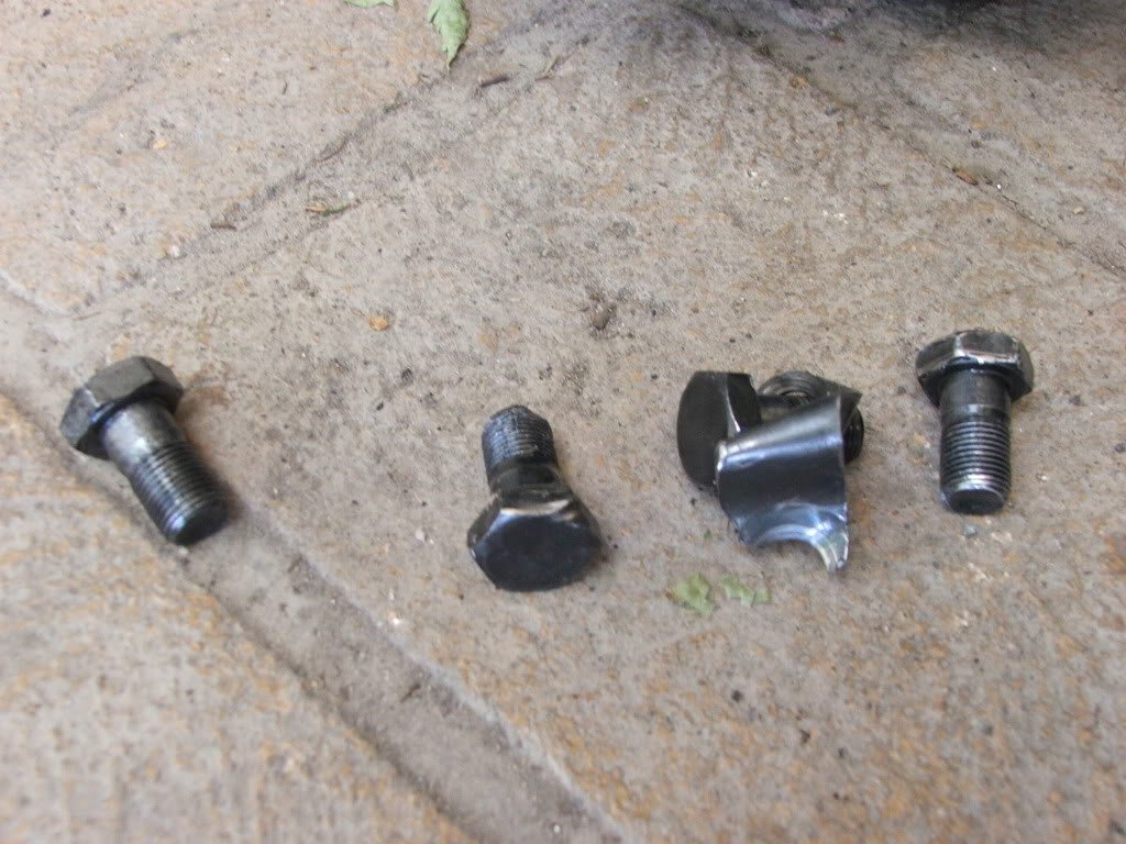

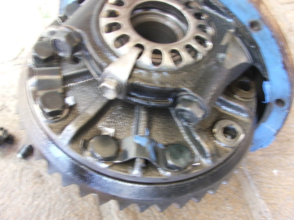

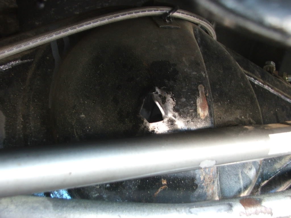

    Basically turned out to be not as bad as i thought but could have been a lot worse if timing went to shit, as in if it happened on the Dyno or the track.
    Basically what happened when the centre was built by Craft Diff's they made basically a "Apprentice Mistake" the bolts that bolt the hemisphere to the crown did not have their tension plates tabs lip'd over the bolt heads, in turn the bolts have shaken loose (god knows how its take all this time to happen) and four bolts got loose and basically exited out the rear of the diff housing (pumpkin) thank fully the only damage was to the diff housing which is a easy fix and two tension plates are shreaded.
    So could have been a lot worse i guess, just was shit timing as i was so phsyc'd to get on the skid pan and bust some hard parking with Travis, bad thankfully Travis seen to be doing a good job of that all day! .. I guess the G series is still the UNBREAKABLE if done right hahaa
    Some pictures to help explain a lil.
