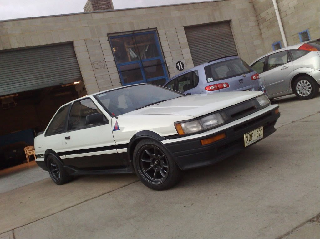

    I've owned this car for a bit over 2 years now, i bought it originally from japanese motorsport after having a couple of previous sprinters, this was my first experience in having something that was actually JDM and i enjoyed driving it every day to and from tafe, as well as delivering pizzas around the hills in it by night. (insert ADM takumi joke here)
    the car when i first got it
    I did all the compliance work on the car originally, which was a fairly simple project - the car was pretty much bog standard and even an auto, so it passed the compliance inspection easily.

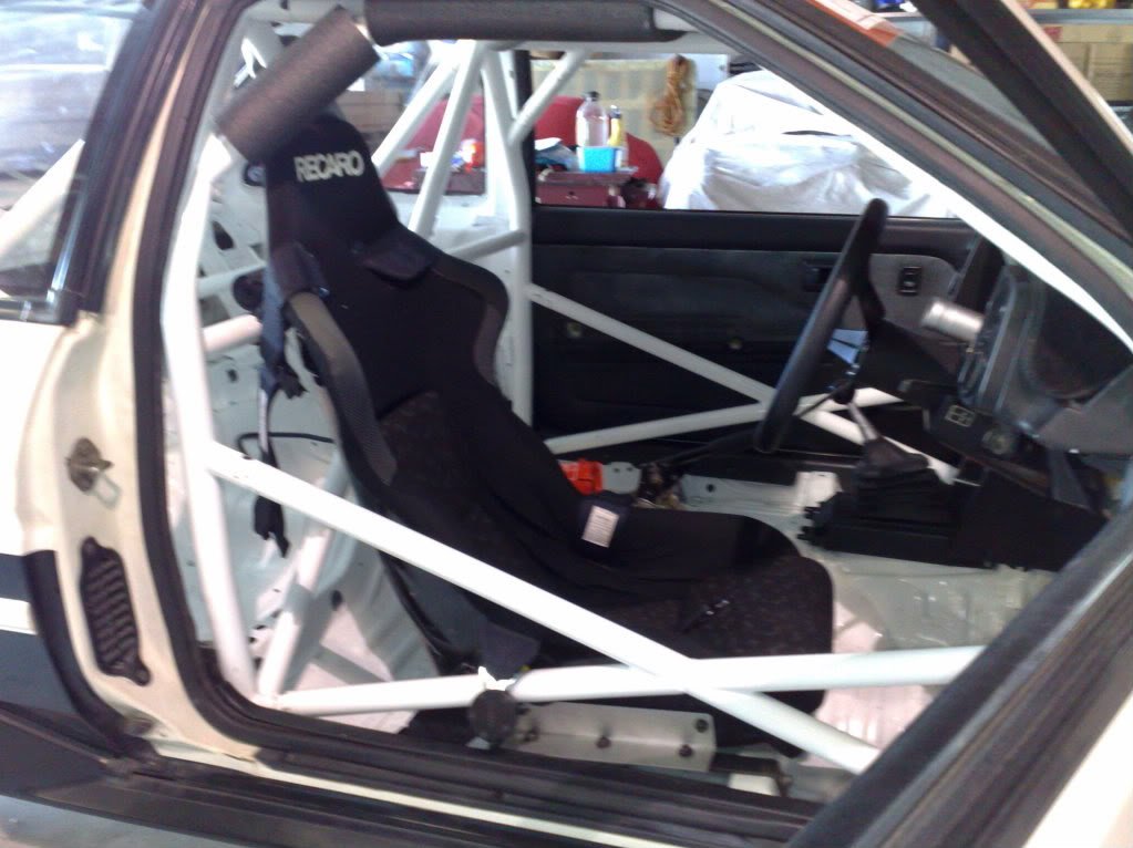

    cage fresh from powdercoat
    part way through cage installation
    finished!

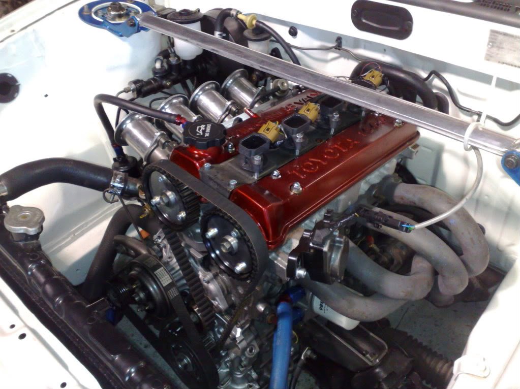

    More of motor
    The car went to buddy parts to get a full cage fitted, and the motor was rebuilt with a baffled sump and some cams, and now makes 95kw at the wheels. I stripped a whole lot of stuff out of the car because it had full trim up until this point.

    4age bigport
    266 degree cams 8.1mm lift
    ported/shaved head
    balanced bottom end
    20v throttle bodies
    FGK extractors
    2" exhaust
    Haltech E8 ECU

    Full 'monkey bars' roll cage (thanks buddyparts!)
    Velo drivers seat with custom super low rail
    Velo 6-point harness
    Nardi Deep Corn wheel
    odyssey battery relocated to rear seat area

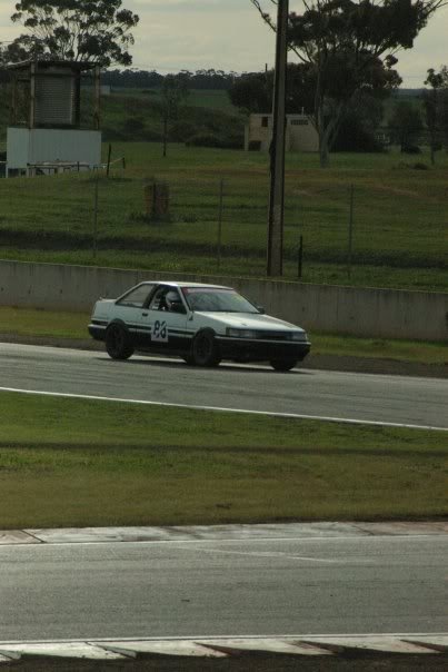

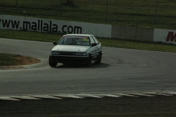

    some photos from the supersprint (cheers madison)
