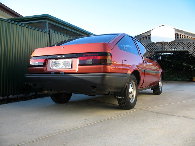

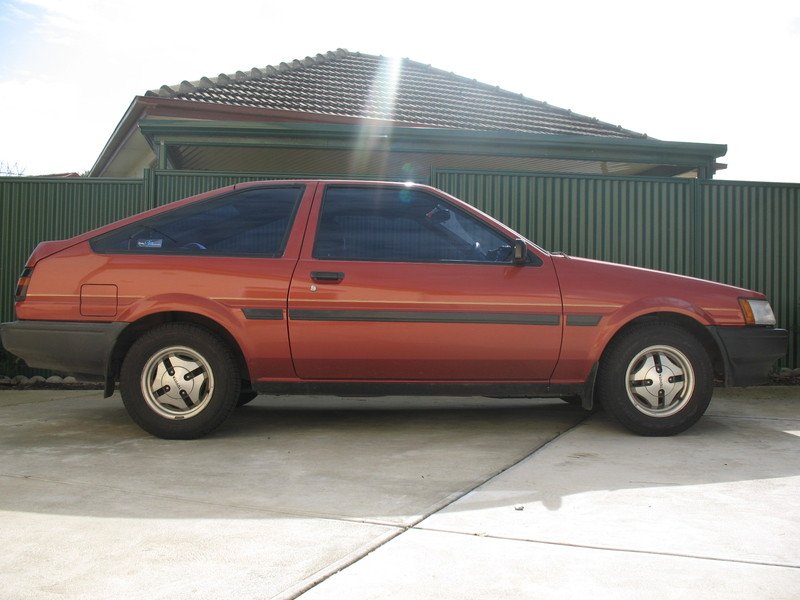

    Here's some pic's.
    When i frist got it.

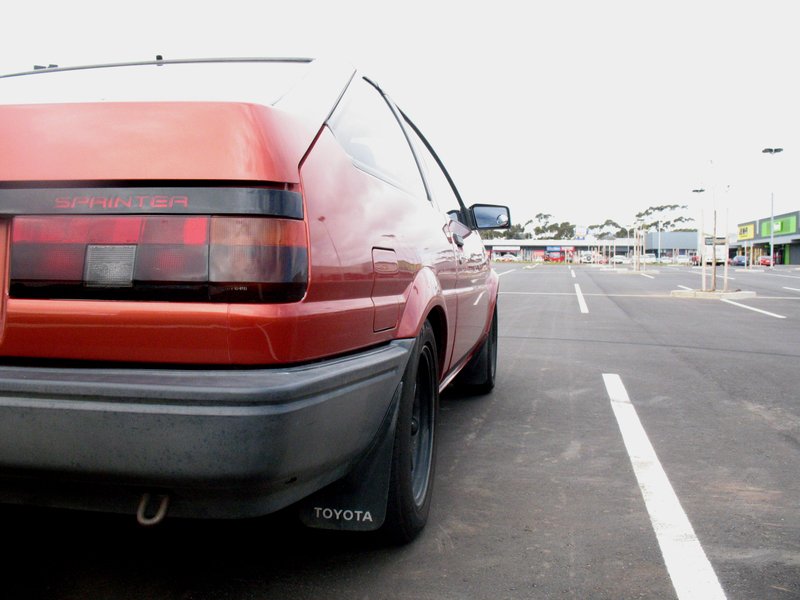

    Imageshack keeps stuffing up the pics.

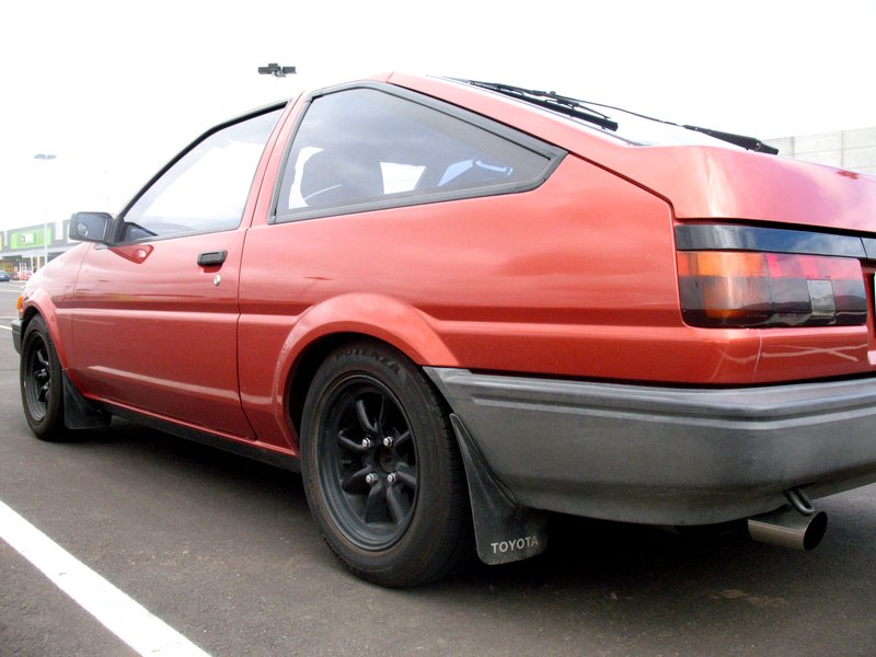

    How it sits now.
    No, those skids arent from me, I only realised they were there when I was looking at the photos.

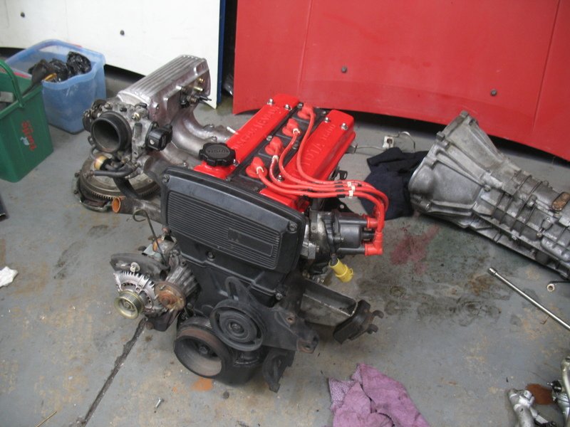

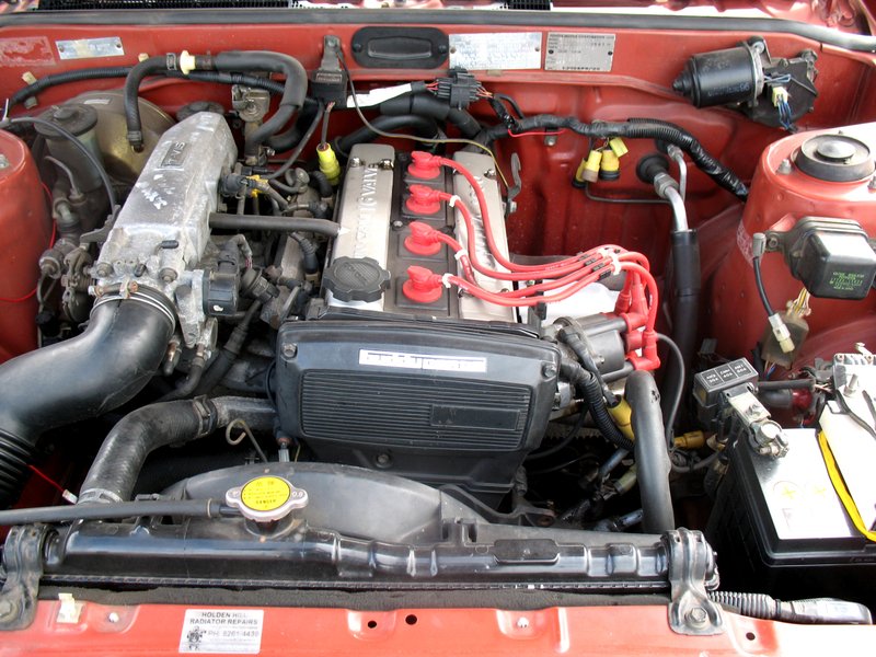

    The new engine is basically built and ready to go in.
    Specs are:
    - TRD head gasket
    - 304 8.5mm lift inlet cam
    - 288 8.5mm lift exhaust cam
    - HKS valve springs
    - adjustable cam gears
    - heaps of porting
    You might know this engine from Jay's green coupe. He ran carbs but i will run it with injection and a standard manifold.
    I've got an Adpatronic in the way and will hopefully be installed on friday.
