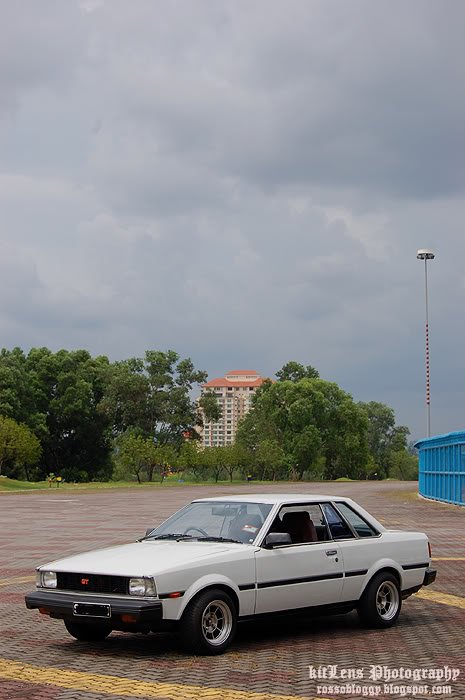

    well ae70's (presuming you are talking about the t18 back styled shape) have pillarless doors to start with dont they?
    if that is the case, then no they will not. the guard side of the door is the wrong shape, and so is the door jam side. and obviously the lack of pillars will affect the fitment.
    if however it is a sedan styled ae70 (the type similar to our aus delivered 4 door 'regular' ke70 but obviously with 2 doors instead of 4) then yes. they will.

    ah yeh sorry its the t18 style (top pic)
    i was planing on going aus flat front insted of the jdm front and thought it would all bolt up but as u said completly different
