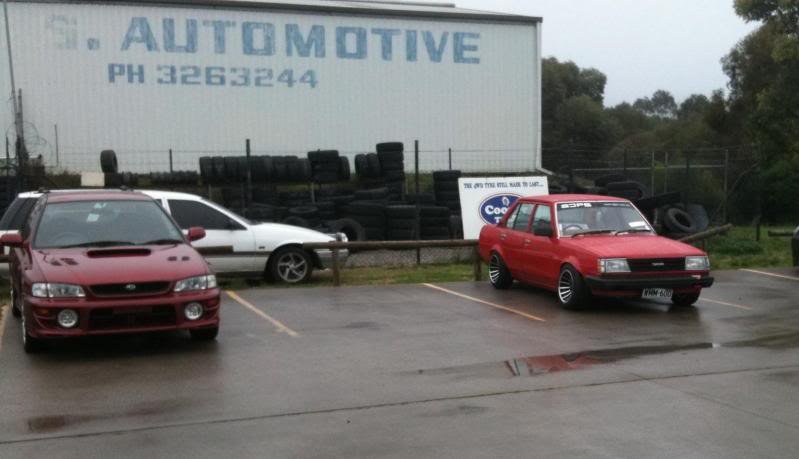

    cheers guys. The cars just sitting at work now, the timing belt tensioner is making a bit of a dry bearing noise so i'm just going to put a new kit in next week.

    haha, no rego i just put the plates on when i get day permits.
