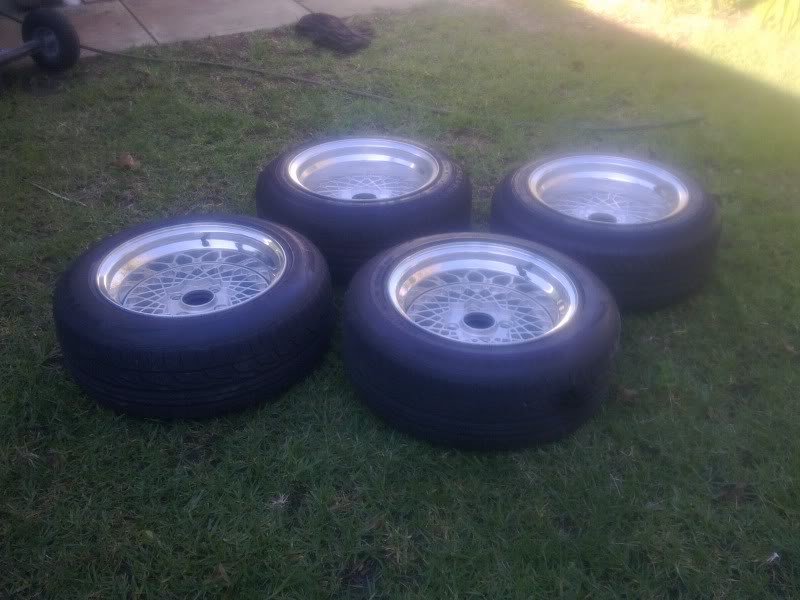

Ohey. Wheels are all polished and I painted the centres silver. Tell me what you think?
