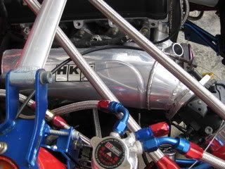

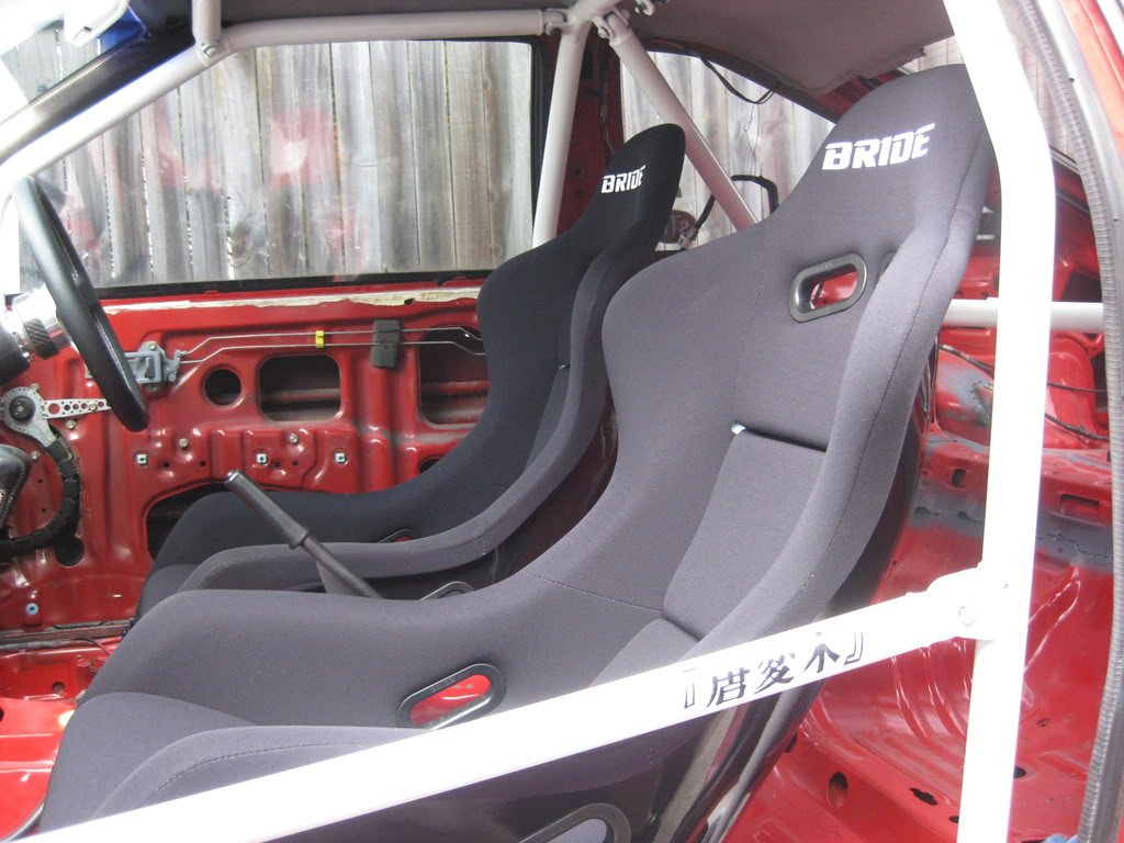

INTERIOR: want it down around 750kgs when done
- bride zeta III bucket seats
- omp 3” 4 point harnesses
- striped bare nothing but open gate to hear
- 6 point cage with side intrusion bars
POWER: 300hp atw
- was 4AGZE now 4agte
- Balanced bottom end
- ARP everything from main, rod, flywheel, head studs bolts
- Lightened crank took 2.5kg of it
- 440cc injectors
- ported head bigger intake and exhaust ferrea valves formula Altaic ones
- hks valve springs caps and collets
- hks 264 intake and exhaust cams
- hks cam gears
- comtic 2mm head gasket
- custom intake manifold with bell mouths inside vn v8 throttle body
- custom exhaust manifold
- Rebuilt Garrett turbo similar to a high flow disco potato running 20psi
- hks 50mm gtII wastegate with screamer
- 3”turbo back exhaust to a titanium barrel
- exccedy 5Puck sprung button clutch
- FMIC
- Custom sump with extra 1lt oil
- Remote mount oil filter and cooler
- 5/16fuel lines
- bosh 044 pump
- holly lift pump to ARE 2.5lt surge tank
- 2x10" Thermo fan
- Drift Pod filter
- header tank
- koyo alloy radiator for a 86
- Peterson oil catch tank
DRIVETRAIN:
- huilux diff with kazza 2 way and r31 disc brakes all new
- stock t50 till I get w58 and one piece tailshaft
SUSPENSION:
- Adjustable k-sport Panhard rod
- k-sport coilovers front and rear
- k-sport 4link pillow ball rear end
- cusco full adjustable castor arms and mounts
- cusco strut brace
- DBA's rotors vented and slotted all round
- Whitleline swaybars
EXTERIOR:
- streeter kit
- d-max front and rear fenders +40
- frp dori bonnet
- orgin frp doors
- j-blood frp hatch
- j-blood Perspex windows
- ssr reverse mesh 15x9-15 front 15x9.5-10 rear and 15x9.5-30
- 195/50/15
And would have forgotten stuff
Built by KC WORKS
