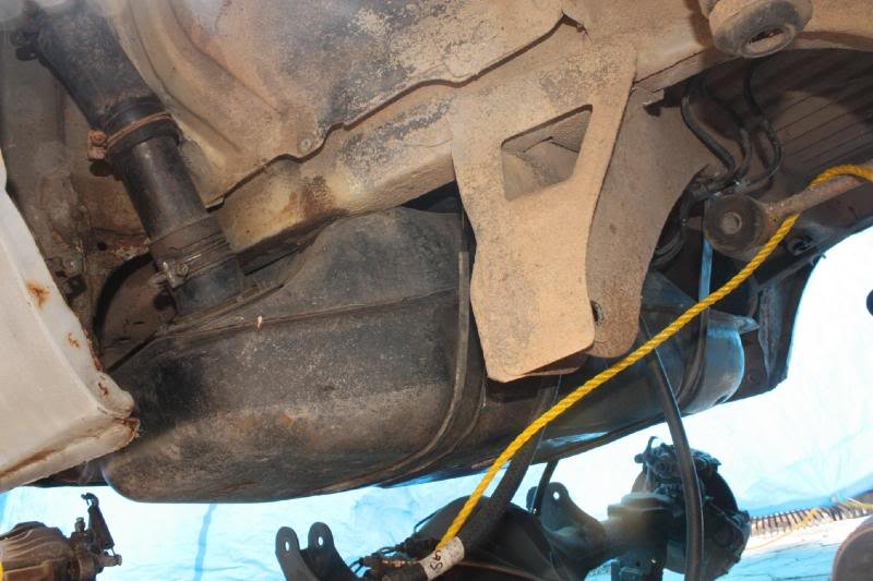

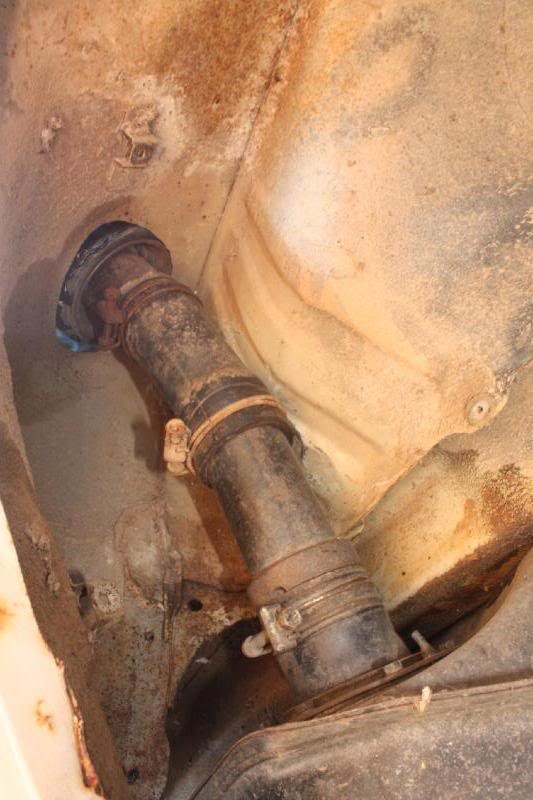

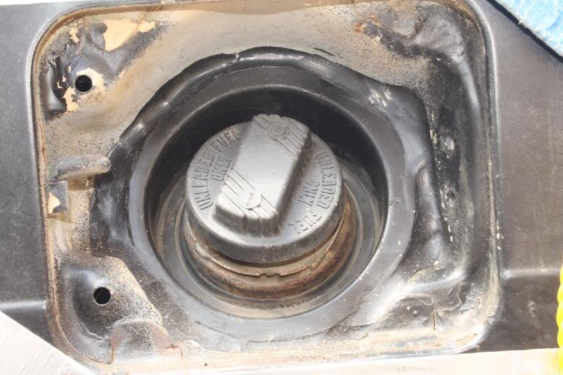

    i dont see why this is so hard... il take some pics.. my jdm tank was into my 70 in less then 30 mins... ill take some pics now and post later...
  10. #30
    Gone
    Joel
    Picton
    4,042
    Pics:
    The rubber section was straight of a ke70 filler neck.. just cut a small section out and insert the tube.. fit clamps... done
