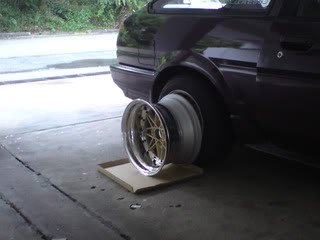

    I tried Huw's Equip 03 15x8.5 -22 (A Disk/Standard) over my RX7/EG6 brakes, and compared to SSR Formula Mesh 15x8.5 -21 which needed a 12mm spacer to clear the caliper, Equips only needed 6mm slip on to clear them.
    Also as the Equips center is sandwiched between the rims, the lips already 1/2" deeper then the SSR just because the Mesh is bolted in from the front. If you went to O Disk/Deep Rim would have even more lippage.
    come in A and O Disk while are A or R Disk (O Disk is 4x100 only & T Disk is 5x114 only) The R Disk/Big Brake Meisters in 15x7 +0 or 15x7.5 -6 would be my pick for clearance and still a fat lip.
    disk type doesn't affect the offset in relation to where the wheels sit, just the brake clearance.
    it does however change the perceived amount of dish.
