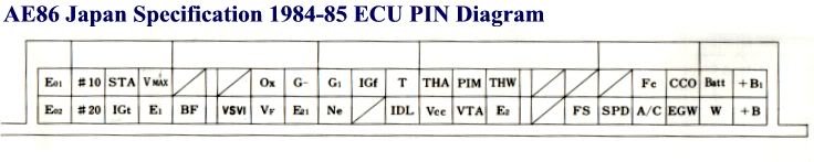

    ok you need to ensure these three wires have power when the ignition is on
    batt
    b+1
    b+
    you can se their location on this diagram
    if they do, then the ecu should be powering up, if not, then thats your problem.
    the two relays on teh strut tower provide power for the ecu and fuel pump. trace the power through these

    ok so i have checked the point on the ecu that u showed above silde 86 to find there was no power ther so i went and got a new relay and now its sparking
    ... now its just the timing which i may have fuked when i tryed the other dizzy i cant remember puting mine back in after trying my spare therefore cant remember lining it up alright (now im feeling stupid) so will have to get someone around to look at the timing but it looks like the problem is fixed
    thanks for all ur advice its been heaps helpful
