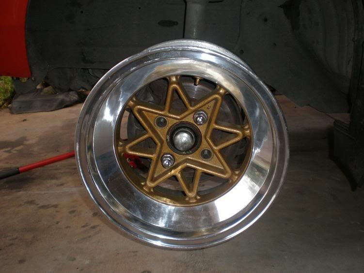

    4x Techno Shadow? 14x8 - 11 rears, 14x7.5 - 3 front
    (will be running Potenza Adredaline's 185 60's all round)
