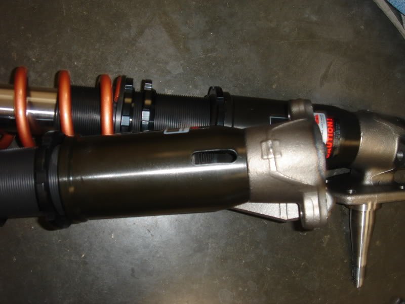

looking at the pics. how the hell would you bolt up a steering arm if the adjuster pokes out the bottom of the rca.

this seems like a great idea. price seems abit steep. but when you think about dont have to pay for struts and they have an rca.

After a long time in R&D (couple of years actually) we are proud to release the new HSD **-type coilover kit for AE86 Sprinter, Trueno, Levin and equivalent Toyota chassis numbers.
This is a true bolt-in kit, with all the best stuff for this model.
The front units feature and inverted mono-tube damper, with a special offset pillow-ball camber plate that also gives a caster increase.
The inverted damper means you have a thick top shaft for maximum strength and reduced unsprung weight. A complete stub-axle is included, with roll-centre adapters and longer bolts under the unit to reduce bump-steer. As the damper is inverted the adjuster is hidden inside the base, so for easy adjustment an extended adjustment knob is included, with a stay to keep it out of harm's way. Like all HSD **-type coilovers, the height adjustment is made at the base of the unit and there is a slot cut in the side so you can easily see how much lower or higher you can go.
The rear features adjustable-length mono-tube dampers with 15-step damping adjustment, plus an adjustable spring seat and new short spring. As this kit is designed for drift and race AE86 cars the included spring rates are 8kg front and 6kg rear. Any rate can be swapped into the front, but at this stage 6kg is the only rate for the rear. More rates will be available according to demand.
Due to the complexity of the kit the price is a little higher than other **-type kits at $1899, but this is still miles cheaper than equivalent kits from Japan.
whoops must not be allowed to link this up here the H R is blocked.

good to see another company quoting "r&d"....clearly they need to fire their R&D department looking at those coilovers
adjuster knob in the bottom...yeh thats heaps sick...so in all their "r&d" they couldnt work out that you wont be able to get to the adjuster once the strut is in, unless of course you cut a slit/hole in the rca...and that would be very safe, i suggest we all go and do it to our current setups

its an inverted damper.... thats what inverted means, its at the bottom ..... maybe try a bit of R and D yourself??
and what fucking on car pics you want????? just a random lowered 86?? yeah win.
these are possibly pre production images produced for advertising blah blah.
this is the usual solution to inverted adjusters on 86 and other similar styles. Oh yeah, what model... DG5 only one of the best suspension setups available for purchase.... but yeah inverted so what the fuck would they know?

i am well awear of what an inverted damper is...you have clearly missed the point i was trying to make...
you have also then brought DG5 into the argument...yay cool, they have made it possible to get to the adjuster on their inverted setup...HSD HAVENT, which is the actual point i made...
maybe you need to re-read my post and point out where i said "inverted dampers are the worst idea in the world ever"...
