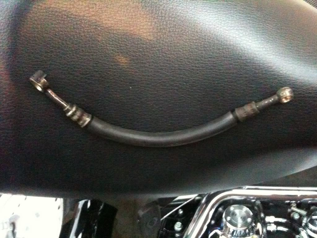

Hit the picky wreckers, i believe injected SV22 Camry or ST162 are the same but a bit longer.
Yo fellas,
I just need one of these but longer to fit my 20v convo as the stock one is too short.
Sankyou.
How much longer?
prob about 2 and a half times longer
i was at the wreckers today and i saw that some newer corolla's have them about 2 times longer than normal ... and i think some old camrys have it to ... but the newer camrys have a larger banjo bolt...
what you could do is get a fitting that the banjo bold could screw into that then leads to some more pipe then get another one of the fittings that it screws into and ether run that into a 2nd pipe the same as what you pictured or straight into the fuel filter ... or just mount your fuel filter closer or change to an inline filter and just run the banjo bolt straight into some fuel pipe.
lol good idea bud, though i reckon easiest option is just a longer one..
does anyone know what model car?
Alternatively, drop in to pirtek and see if they can make something up for you.
I have used one off a AE112 Corolla, I think...
yeah somewhere like enzed should be able to knock one up easily for you
