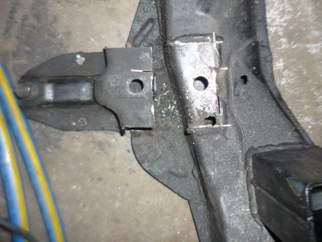

    X-member... Started...

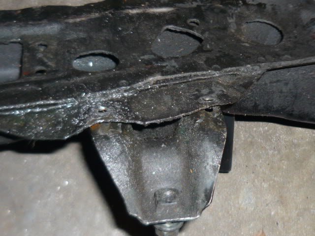

    First.. drill the spoit welds out. You should end up with something that looks roughly like this..
    This is after I stuck a cold chisel in there to open u the gap..
    Second.. cut through the steering rack mounts inside of the welds.. with a bit of luck it'll turn out like ths..

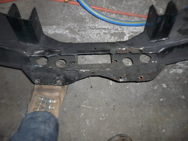

    Then mark our how much you want to move the rack forward...
    I chose ALOT. and ended up with this..
    Please note that that it took an air hack saw to cut through the interenal baffels and get it to this stage.

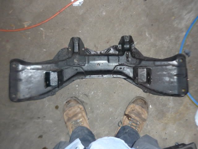

    And here is what it looks like BEFOR you start... for future reference
