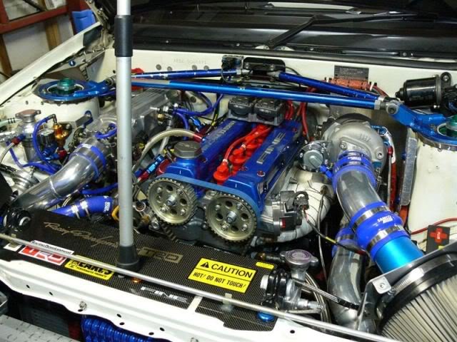

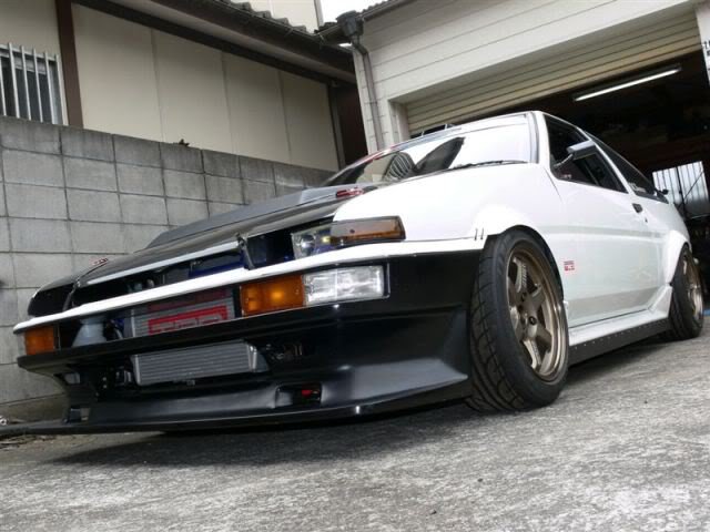

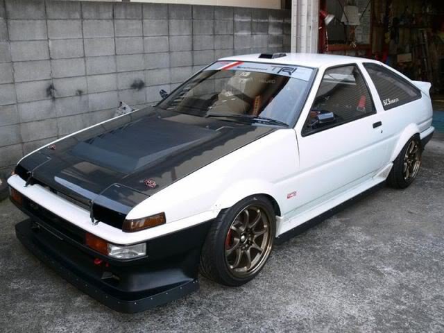

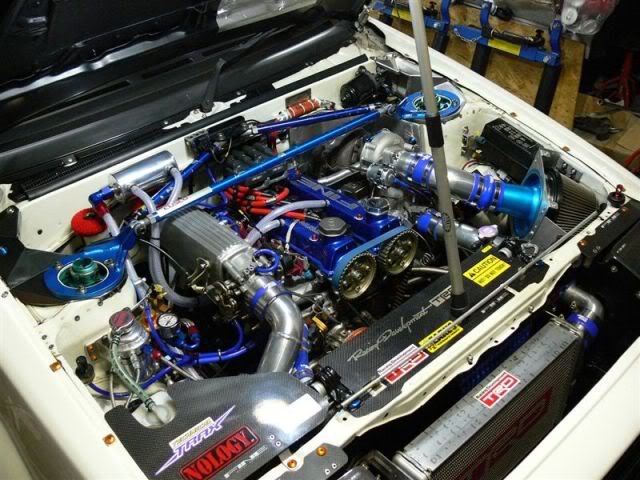

There seemed to be a bit of interest in this particular hachi so here are the specs (Translated) and some pics. Enjoy!
★ ★ Engine (4AGZE based) ★ ★
・Toda made port + Hairifutokamu · N2 head for turbo processing chamber (IN272, EX288)
・Valves IN the TRD (1.5mmOS) EX for 3SGT side (3mmOS) HKS valve springs made of oval-tech art made Innashimukitto
・Reforming process set 4AGZ · WPC piston compression ratio 8.5
・JUN-made products Heddosutaddoboruto Kuromorikonroddo · ARP
・ARP, Tomei made Kurankukyappusutifuna Meinsutaddoboruto Furubaransukuranku 4AGZ process modification made for WPC
・Arumioirupan made, works made Reshingusutorena Napurekku + SS + baffle made of anti-bias EX HKS Mani (processing expansion port) + Sten-made gaskets Tomei Power Enterprise PE1420 EX-made turbine processing (300PS will boost up over time about 1.3kg)
・76φ original outlet, stainless steel
・Front pipe, stainless steel oval titanium muffler Ranebointakura 80φ Original Original (Orijinaruarumipaipingu)
・Layer 3 + Arumisaidotanku radiator, oil cooler, electric fans made BILLION Heddatankushisutemu Trust made (16 steps)
・Blitz, made injector (525cc)
・BNR32GTR main fuel pump for the sub = 7MGT Freedom Control for E & E products (the same as control Tues)
・Ultra Electronics, Nagai made MDI9600
・5L Third-made hot-wire, made Busutokontororatoriga Noroji original 4D GRID Axela Antilag system made following PCCS 2 + ALS Fyuerukorekutatanku bypass air pump Made in Burobaisepareta third party made the original adjuster adjustable Fyueruregyureta 5L
・Orijinarufyuerukura (Earl's 13 core columns made of fan-cooled electric +)
・Third + Uotainjekushon made, made in reforming Akuamisuto Intakurauotasupure DDS3V10

★★ Footwork ★★
・All major sports car harmonic integral expression · GP (G Master PROS Breaks)
32 Made Swift inverted type front-stage adjustment formula ⇒ Herupariya 10kg + Craft adjustments made to order 32 single-cylinder sub-stage 4kg + project Helper 4kg + μ Furupiroamu Height Adjustable Upper Pirro made (Bush reinforced less)
・GAB stabilizer, made before or after (3 adjustable rear stage) or break Romeo GTV (5 adjustable rear stage)
・PROTHANE Sutearingurakkutenshonroddo original, original Sutabipirorinku around polyurethane Bush made Quaife steering rack & pinion + Orijinaruborutoon EPAS
・Quick Torakushonburaketto unknown manufacturers, knuckle-Original (3-stage adjustable)
★★ Wheels/Tyres/Brakes ★★
・Rays CE28N (16-9JJ off +25) or Rays TE37 (15-8JJ off +15)
・Original front four pot caliper (rotor diameter 300mm)
・Rear normal caliper (rotor diameter 260mm)
・Μ original project, made Masutashirindasutoppa orBRIG wilwood brake pads made by Hurst line lock brake system hydraulic hand made Burekibaransa Manufacturer Unknown
★★ Other ★ ★

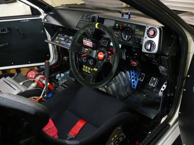

・7-point roll cage, made CUSCO Japan SAFETY21 + additional carbon fiber instrument panel original sidebar
・Corse, made consecutive 3 meter console modification made by Recaro SPG (driver's seat) TRD made the old type (passenger)
・Original door panels made of lightweight, Porikabo
・Acrylic window (left rear door)
・CUSCO Japan, made of modified carbon hood made of lightweight FRP break Kabonkuotapaneru Riyageto Barris (TRD body made Riyasupo 1)
・Saidosuteppusukato FRP Manufacturer unknown, the original front fender Yurasubanpa original Furontorippusukato
・Akira Makoto ventilator under guard for the cold, the original ultra-lightweight mirrors the original fixed light kit fender Unknown Manufacturer Unknown Manufacturer
・Made · Racelogic DriftBox GPS data logger
・GRID made made Nokkusensaintafeisukeburu · HKS Knock Monitor ZOOM Handy Recorder M2-made products sold dry battery
