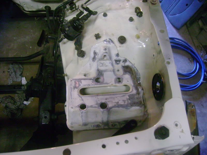

- The chassis mounts have been moved forwards now and welded back on

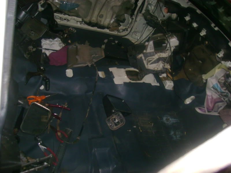

- Got the rear vinyl matting out of a 4runner to properly cover the floor right to the back of the cab

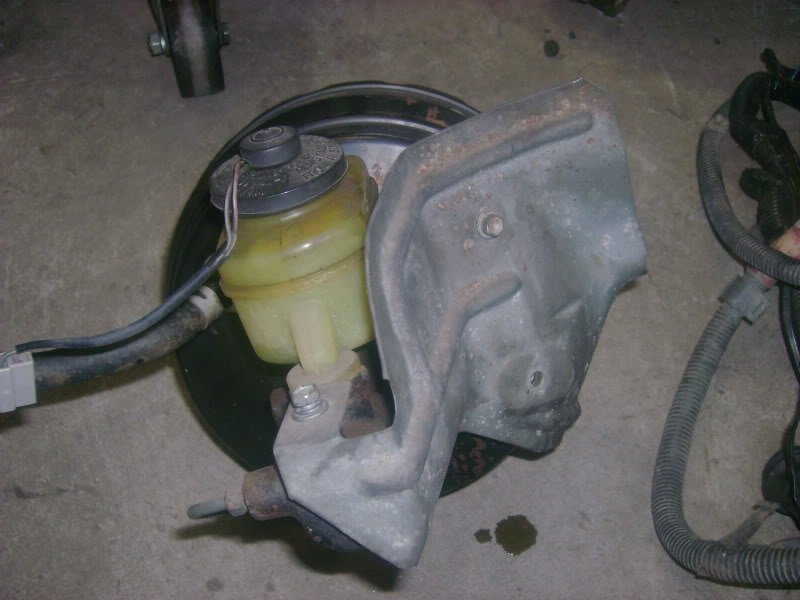

- Got myself a brake master cyl out of a LN130 Toyota Surf turbo diesel

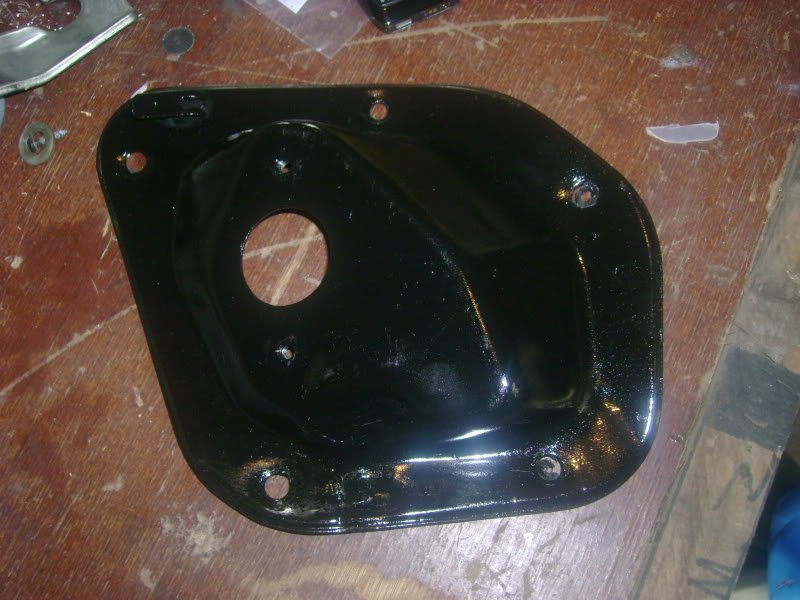

- Finished modifications to the firewall opening cover thingo where the steering column shaft goes though in order to clear the internal clutch master which I'm runing out of a VZN130 4Runner.

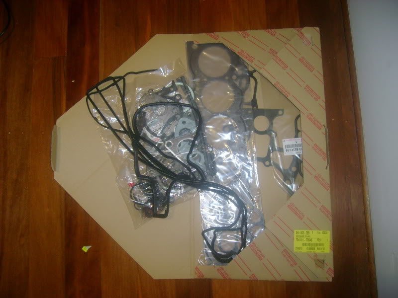

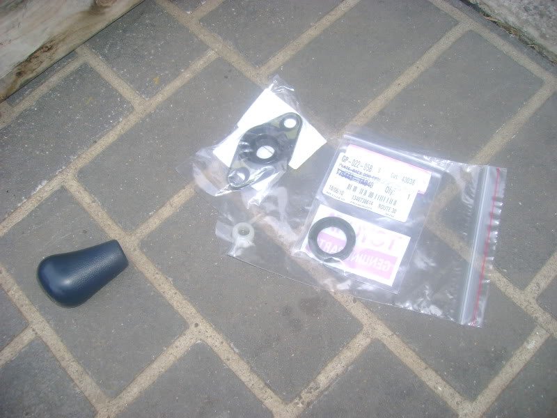

- Got my very expensive gasket kit from Toyota (which I've been unable to fully install due to an impossibly tight harmonic balancer bolt)

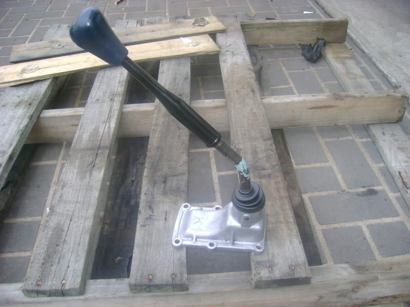

- Rebuilt the shifter from the RZN149 W56 box

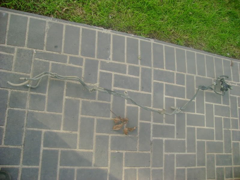

- Got the fuel lines from an RZN149 (suit EFI)

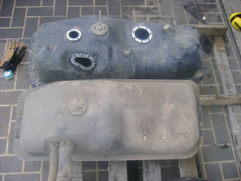

- Got a fuel tank out of an RZN149 (pictured here along side the standard RN85 tank). They are marginally longer and taller but otherwise mostly the same size and shape.

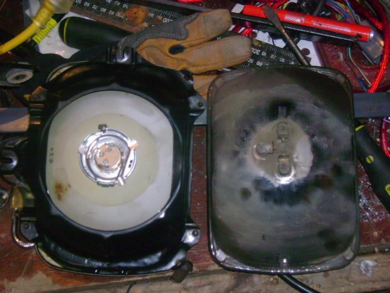

- Got the bits to convert the headlights to suit H4 bulbs

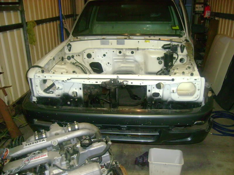

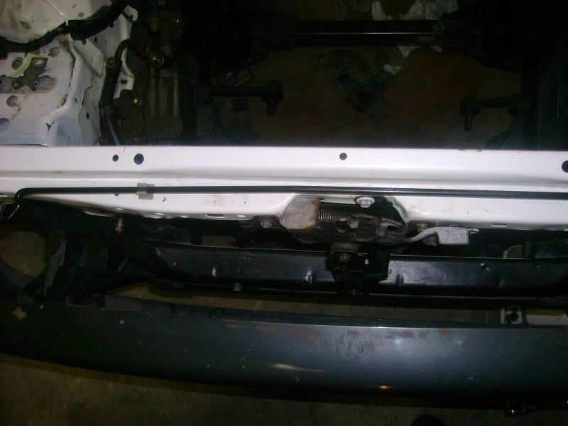

- Borrowed a fucked 4runner bar from work to see how much space it would give me for an intercooler - much more than a standard bar it would seem

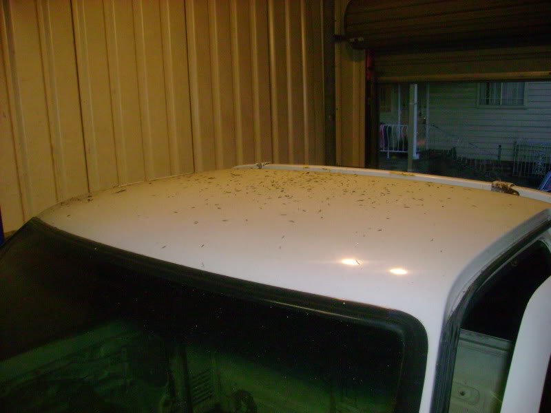

And this is what seems to happen when you stop working on your project car for a while too

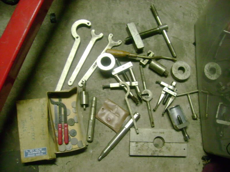

I've also been collecting SST's whenever I can find them
So that just about rounds up the past many months work, but I'm back into it now so hopefully things will take off again
SST1 = Hammer

Yeah, it stands for Special Service Tool. You'll find them called for throughout any of the factory Toyota repair manuals.
