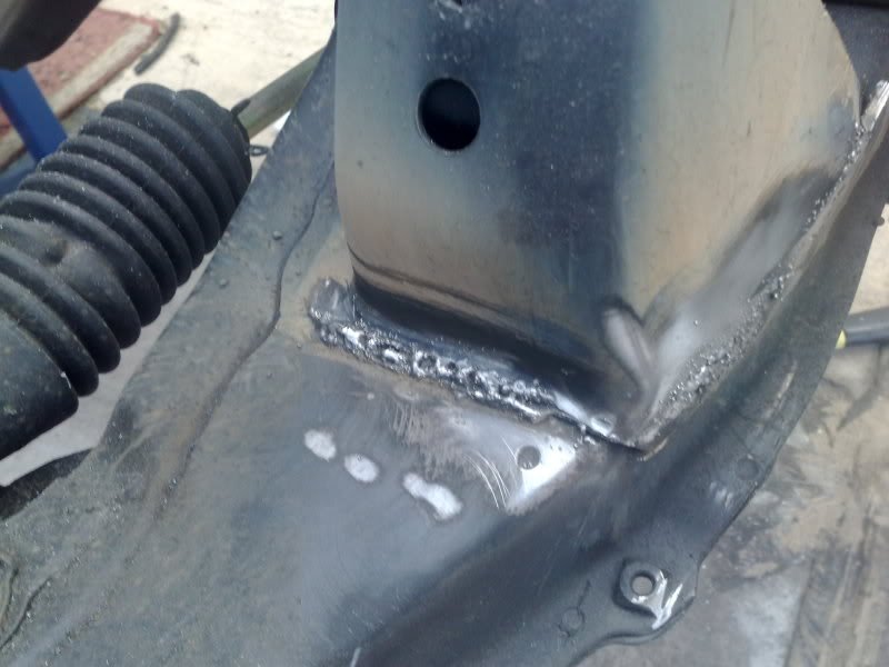

then realised welding aint my biggest skill
soldiered on and started to improve. Had some pointers from a good mate and things are looking up.

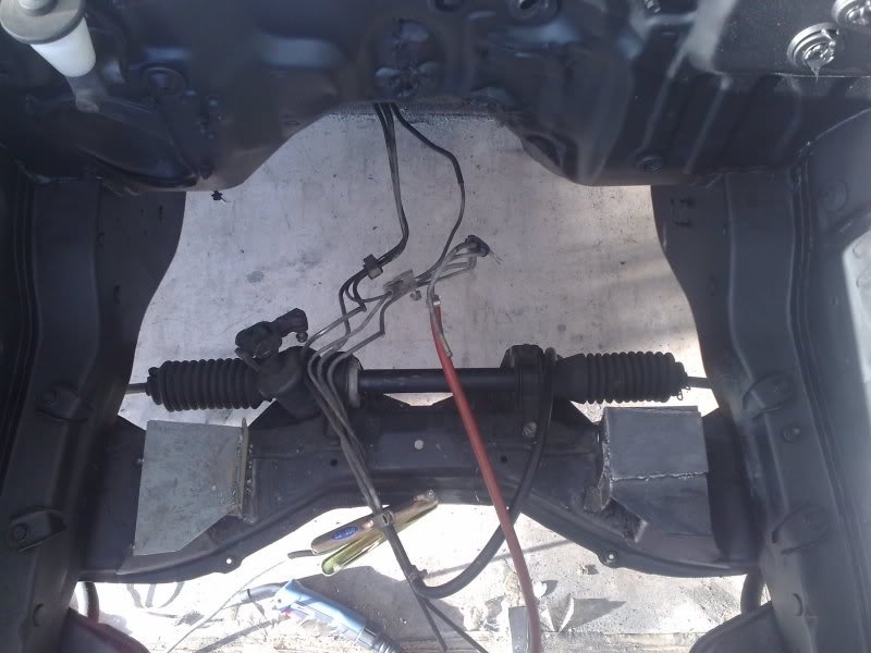

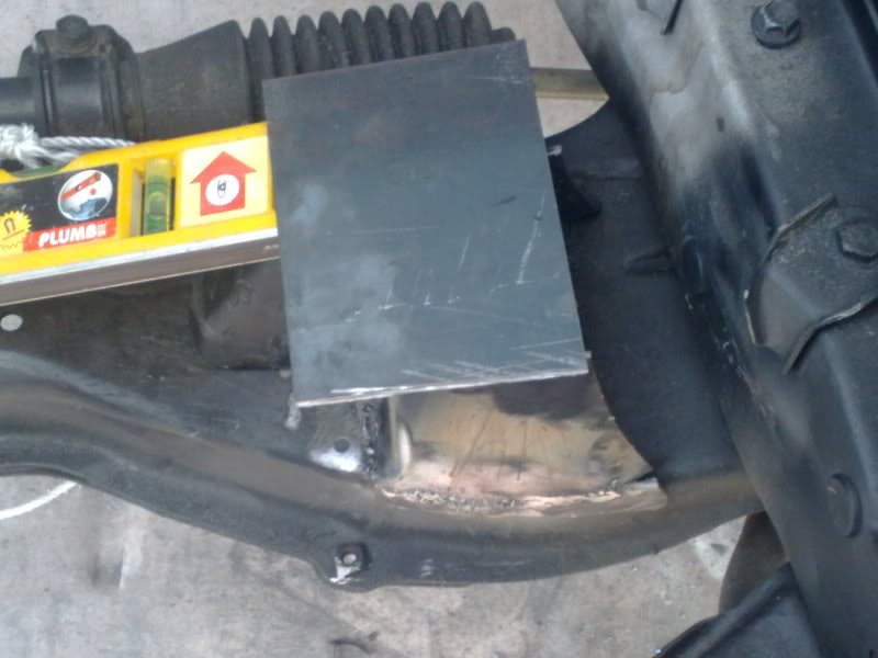

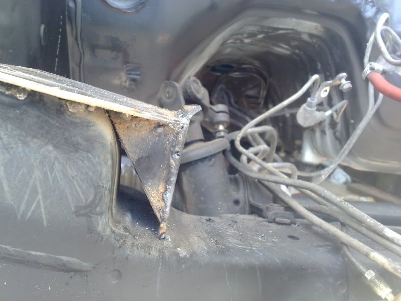

Initially i was going to remove the mounts totally... but im getting over it and just want it and running for the annual. So after realising i couldnt get the mounts off too easy in the car, i welded the first cuts up and changed tack....

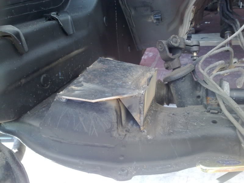

the altezza mounts have horizontal mounts, not angled mounts like the 4a series. So i did some careful measuringand chopped the top of the mounts there to form the base for the horizontal plates. They are also about 3 cm different in height, so that is why they look a little different.

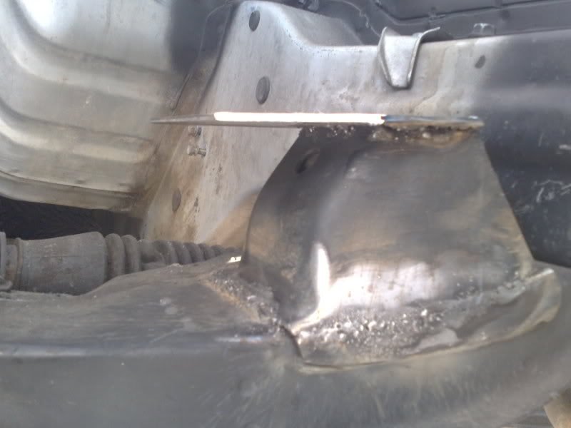

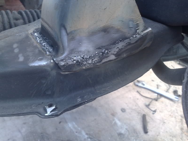

The welding isnt the prettiest, but for every weld completed i hit it with a 5pound sledge really fucking hard to try and break the weld.... none broke
this is an example... the small over lap was belted till it folded near 90 degrees and the welds were still spot on
and the almost completed mounts...
They have, since this photo, recieved a vertical rib about 2 inches wide welded on to the main vertical stay to eliminate bowing, and a second "pad" welded ontop... so the mount face is 6mm steel. - oops its done on the right one

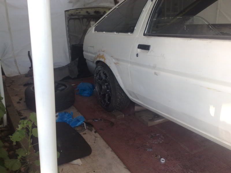

So with the mounts sortedishi set about seeing if it was going to fit the way i thought...

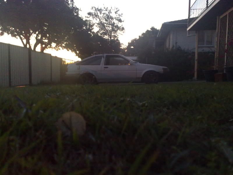

on two wheels for the first time in months...

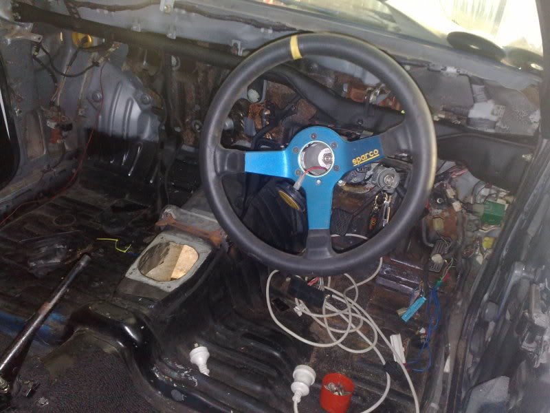

dash bar and wheel refitted to stear with
then rolled to its new home... only real downer so far is finding out the new big brakes rub the wheel a bit

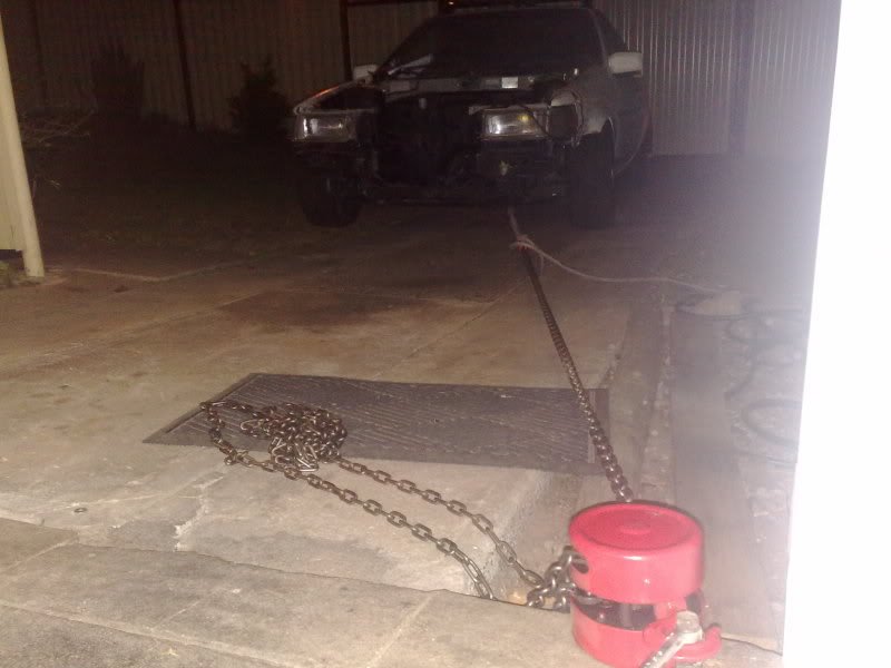

i have a very slight rise to the garage door... and here was my dodgey solution... block and tackle will rule the earth...
this is as far as i got befor i started to hit snags to my one man fitting party

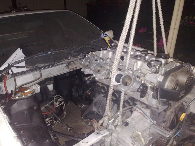

the exhaust manifold was hitting the fierwal and i couldnt get enough height to angle it in myself
so here is where i ended it tonight...
getting there peoples.

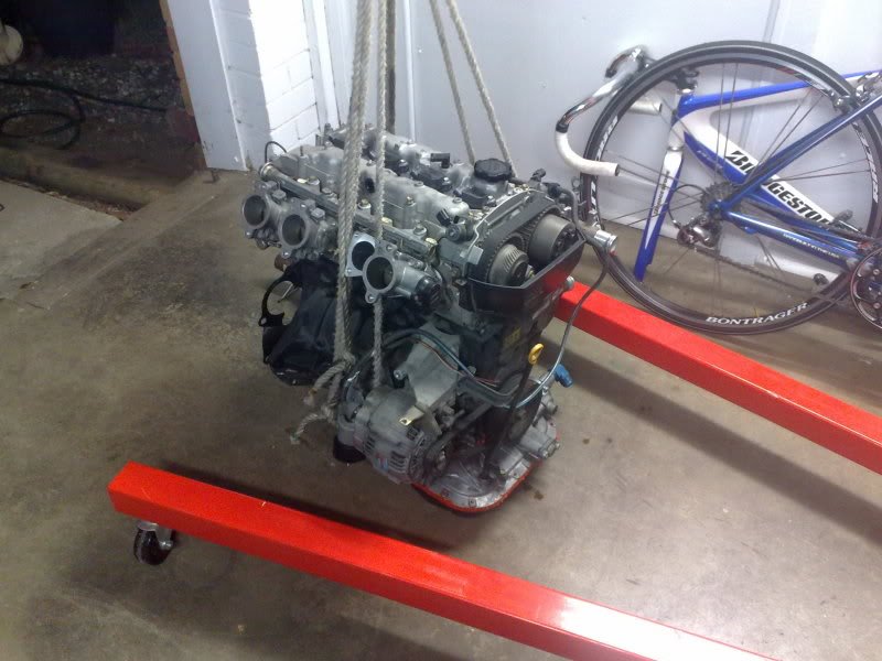

found some new mounts i want to use that will isolate the engine a bit more from the body, the solid ones i have now are goiing to be hell for those welds, if i have some rubber in there it will at least clear that till i make the new crossmember better...."we have the technology" and better weld skills.
sort clutch slave, fork and throwout bearing monday then install the clutch. need to give ant my bell for a few days, put it all together and drop it in, then start on the niggling little bits.

Quick tip: with those welds, try and turn the heat and wire feed up a little. And/or slow your hand a little.

yeah thankds for the tips on the welding - i have learnt ALOT since then, hence my plans to redo them. But these will have to do for now![]()
