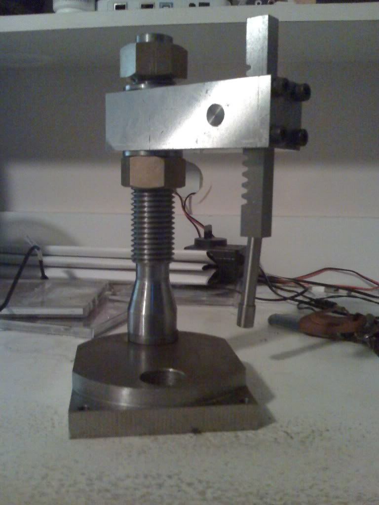

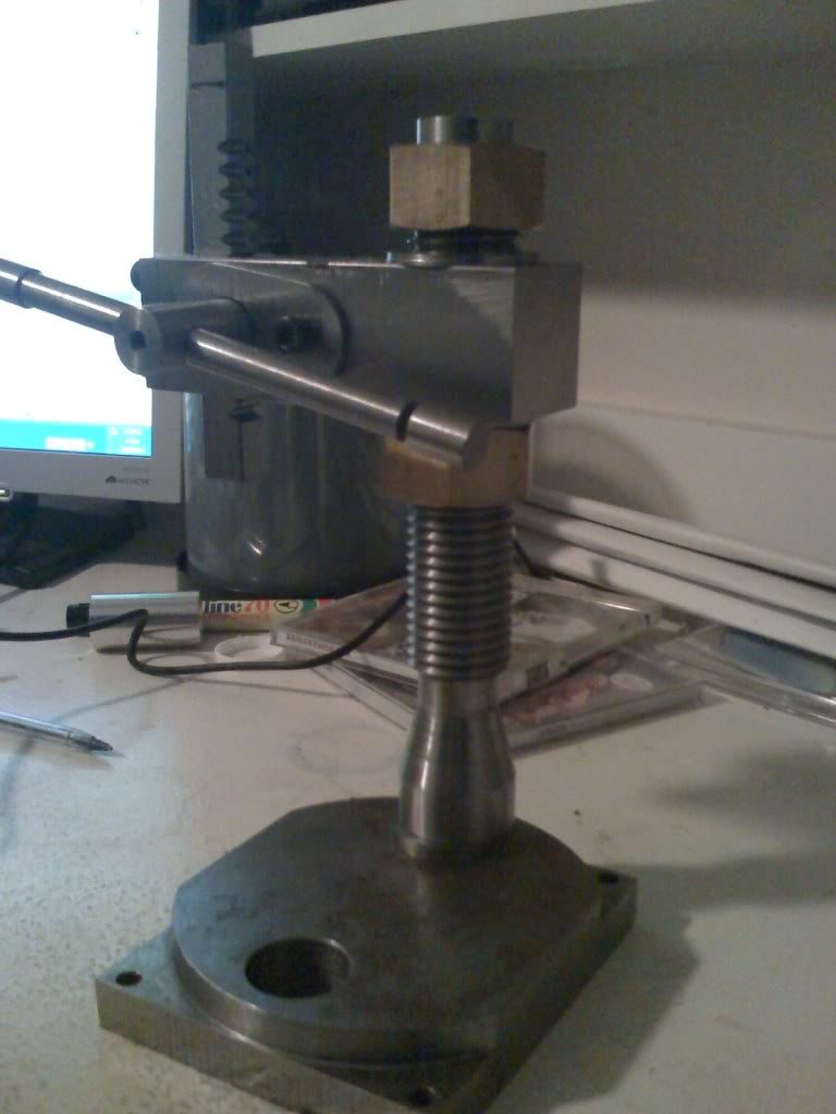

    This is a job I had to make for tafe, it's an arbour press. Everything was made from scratch, from grinding my own HSS 60* tool for the threads to using a rotary table for the base. Tolerances were around the 0.1mm mark (which is great because at work I normally work to a 0.001" tolerance). Eevrything turned out spot on except for one of the cap screw threads which I tapped on the piss because i wasn't paying attention.

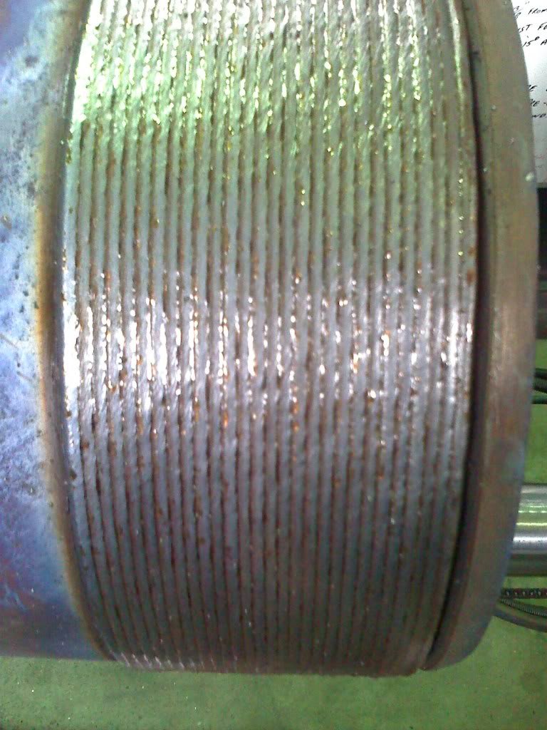

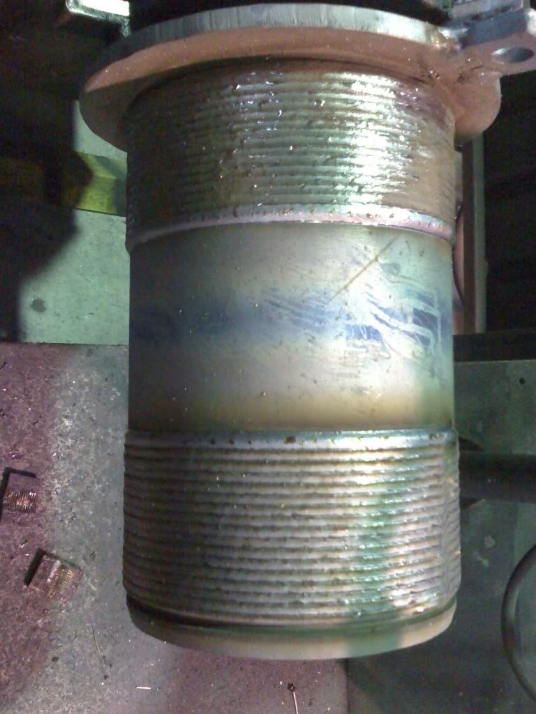

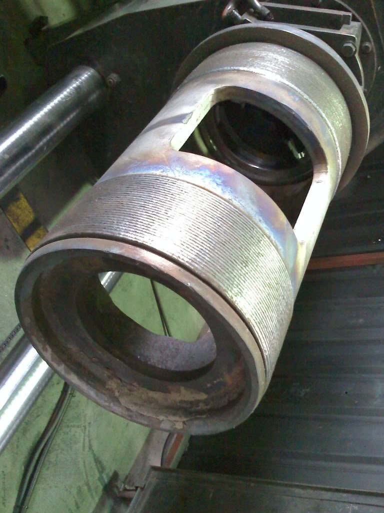

    The other pics are of a large sleeve/bush thing (not really sure what it is) that had a fair bit of wear and needed to be welded up and machined back to size. It was about 15" diameter and the two positions that needed welding were about 5" long. It took about 1.5hours of straight weld for each position using our super old auto feed welder. Once i machined it back to size it had no pinholes or defects which I was pretty stoked with.
