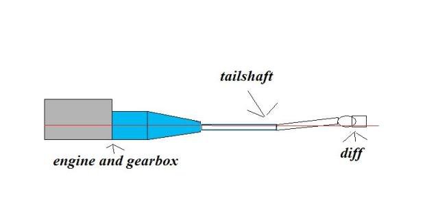

    anyone got good info on diff pinion angles? especially for drift...
    ive done some research into pinion angles and the majority of people like to have the diff nose down 2-3 degrees so under load its even, however those setups all seems to have the diff nose below the level of the gearbox.
    my pinion sits above the level of my box so i cant quite picture in my head the angle it should be.
    also all the aftermarket items for antisquat all lead to pointing the noise of the diff higher not lower, which goes against what all my research on what chassis tuners do.
    any ideas anyone??

    from the crank to the tail of the gearbox should be a straight line, then 3 degrees or so from this imaginary line (not the road level) down at the diff end. Make sense?

    fair enough but if my car is lowered (and yet not ridiculously lowered) my diff would be pointing down a fair amount from where it is to 3 deg below this line

    ah I see, my bad I was thinking one peice tail-shafts. Ok draw a line from the second bearing in the tailshaft to the diff nose and then from that angle dip the diff down a little more than that. Because of this the diff may not look right from the road point of view however it should be right in terms of alignment.
    Can someone confirm this or am I just sprouting crap?

    well if I am not mistaken here adjusting the pinion angle isn't primarily for "how it feels", it's to minimise uni-joint angle and hence wear.
