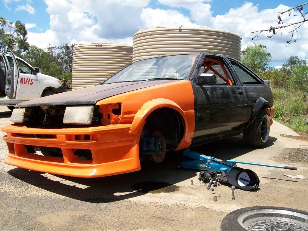

    These are CBY flares Dave... ther HUGE.. lol
    these are 8-4 all round with a diff that was 40mm a side wider than standard and the wheels are still hiding.. That pic was with a normal 86 front end in it..
    It went s13 front and had plenty of room.. back to normal 86 sus now without cby's..

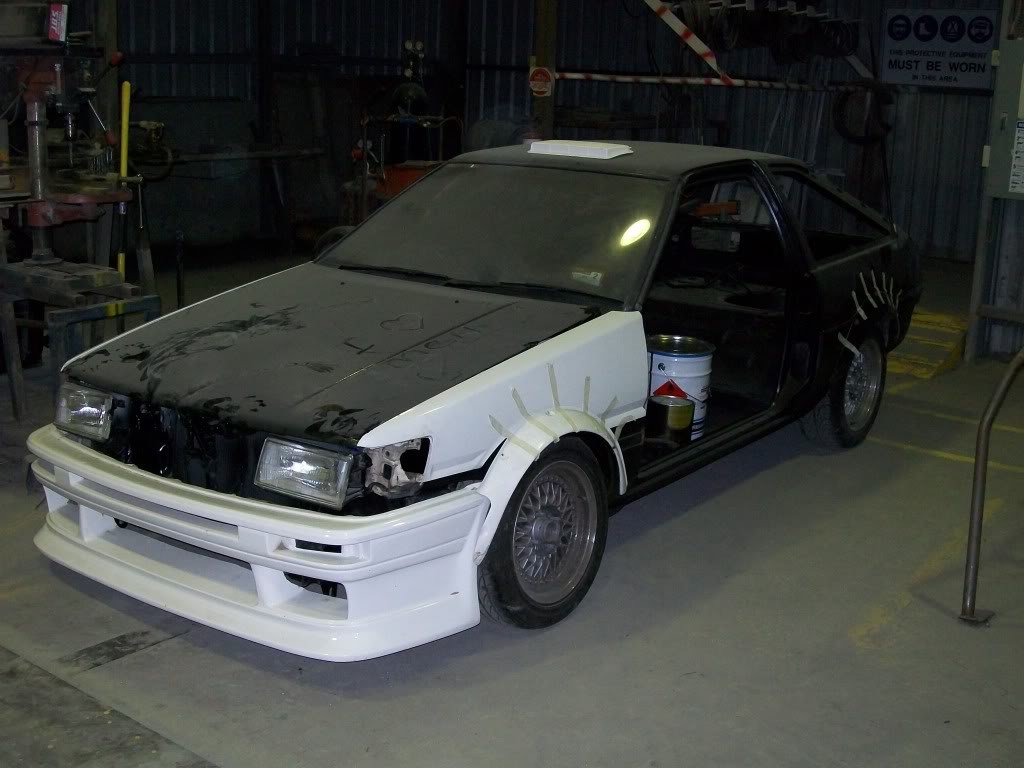

    @ Redwork,, ha,ha far out 15x10-25s up front would be the way
    @ Dave, ya man no shortage of room there bud, recognise the bar?
    @ Fantapants, ive got a full set of these Jubiride style, add 30mm????, you can have em, one favour deserves another, aye.....the rears are about 5mm wider but you could stik them up front in you needed.

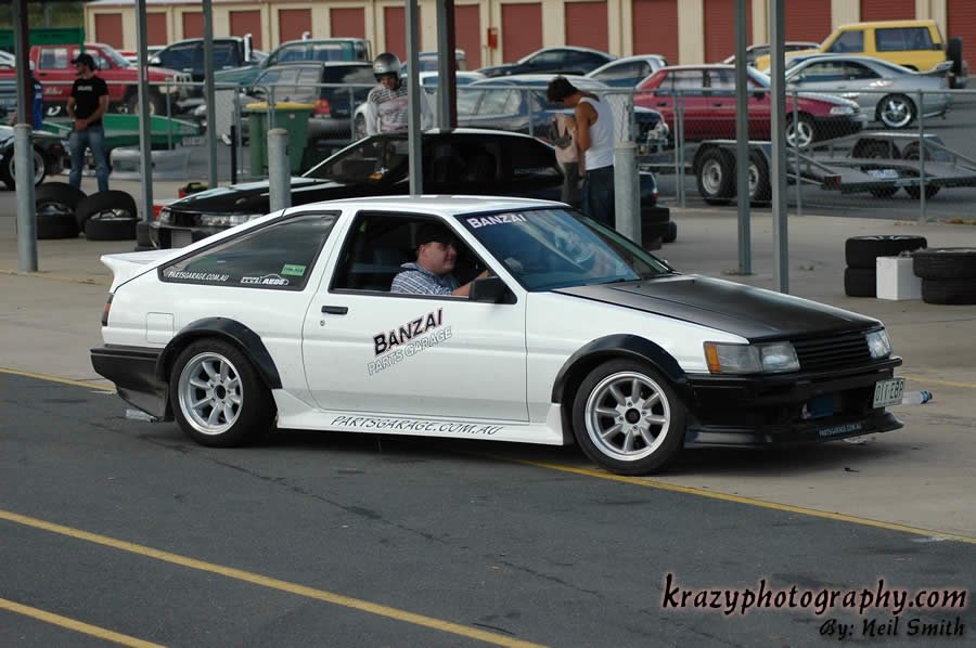

    Working out the rim size/offset isnt easy with CBY flares... theres alot more flare then you think.
    Specs are; Front 14x9 -19 and adjustable LCAs about 30mm over
    Rear 14x9.5 -25, JDM T-Series and 20mm bolt on spacers
    (btw, front is very high atm as theres no engine in it)
