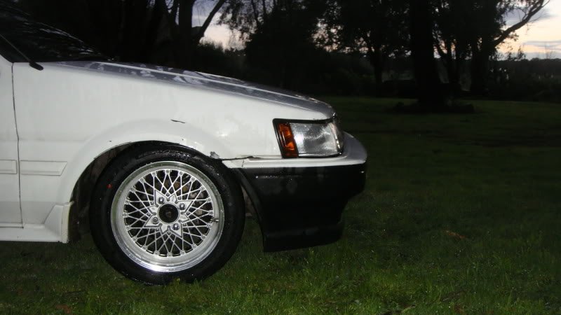

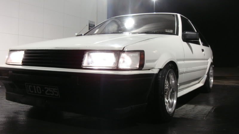

    Well after a few late nights and early mornings this is what I have ended up with:
    Super happy with the result.....guard bashing was good fun, need to do the rears still as they have only been rolled. with the alignment settings I chose, it meant I had to space the front bumper forward and chop off the bumper brackets on the guards so they could fit right. Was pretty simple took a couple of hours to do but its worth it:
    Chucked on re001's all round and they are grippy as fuck......I just have to play around with the setup to see what I like.
    Ended up going
    -2.25 camber
    +4 castor
    +-0 toe
    The lazy prick at the tyre shop didnt straighten the rear end....so I am just going to wait for my 4-link, traction brackets and then get its centered.
    All is good and happy times ahead

    Looks good mate, the BCs firm it up?. How much is that off the lowest setting?

    looks good doode, how did the install go?
