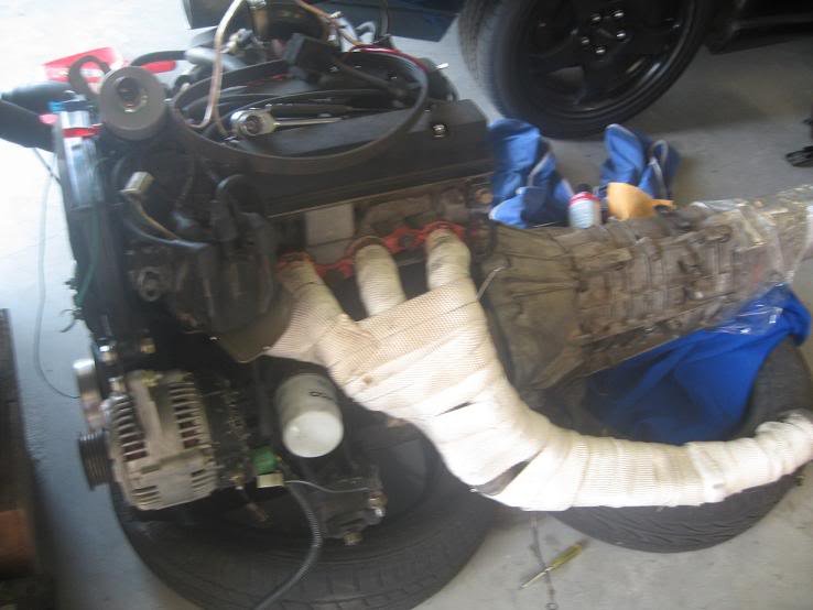

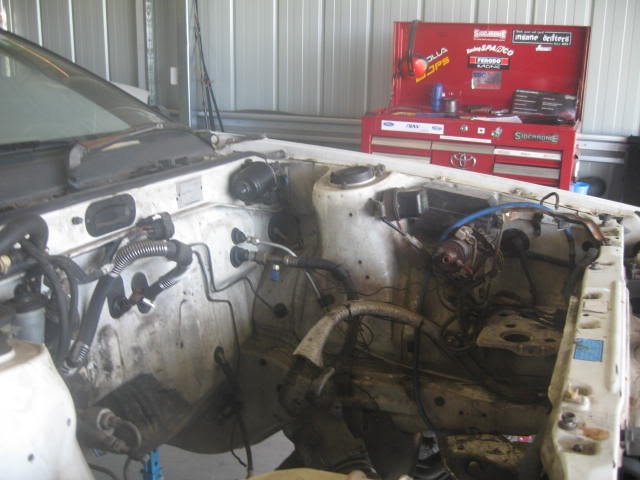

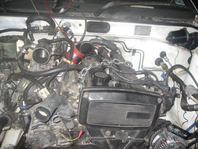

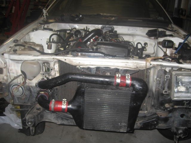

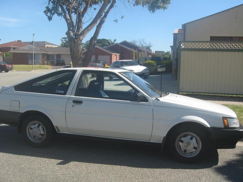

Hi everyone, first of all I like to properly introduce myself. My names Troy, being a an ex Honda fan boy. Buying/ building this car was a huge learning curve, as this was my introduction into the drift and Toyota scene. Being total noob to the rwd drive scene. and having lack of mechanical knowledge I gave me mate Richie (drfta86) to give me a hand on this build. This car gave me about 2 weeks of decent 4acrud action, then it started giving ,e some compression problems. Thus it was off the road about 2 months. That gave me time to buy some goodies such me Bigport gze, superlights and r31 diff. Well we started her last week and this is how far we’ve gone. Bout 12 hours work into this bitch now.
Exterior:
.ATM an adm stocko
but soon to be be:
.Duck wing
.bolt on guards to fit me 15x8 superlights with the r31 diff
.TRD lip/ sideskirts
Interior:
.MOMO steering wheel
.Ebay bucket seat (sidemounted)
.Bout to get gutted the fuck out off
.Soon to be halfcage.
.Boost guage
.Soon to have a giant wog clock
.Soon to have bolt on flares to fit my wheels
Engine:
.AW11 MR2 Bigport 4agze.
.Nevo pulley
.Bigger injectors.
.Trd Metal head gasket
.Custom headers
.Extreme heavy duty clutch
.Slightly lightened flywheel
Drivetrain:
.r31 diff with 4.11 gears, minispooled.
Management:
.Haltech E6A
Wheels:
15x8 -4 superlights with r1r’s

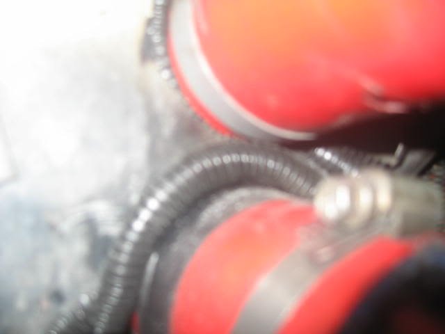

go onto the haltech site, and download the ECU pinout for it, around where the left hand rocker cover is (fomr behind the car) there is a few wires shrink wrapped up, these are for the 02 sensor, I reckon wack one in while you are at it, although then you will need another tune most likely.

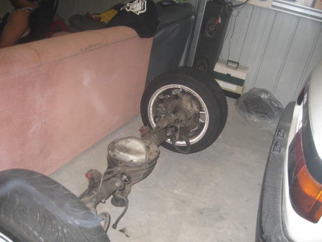

also i got superlight on 31 diff u dont need flares to fit wheels u can hammer them into shape run 195/45 and slam it looks sweet as. if u would like pics ill send u one
It Aint A Motor If It Aint A Rotor.!!!!!!!!!!!!!!!!!!
Yes pics will be very appreciated! =] cheers mate.
