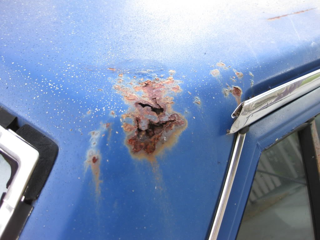

coming along nicely dude fuck thats a bit of rust mate...

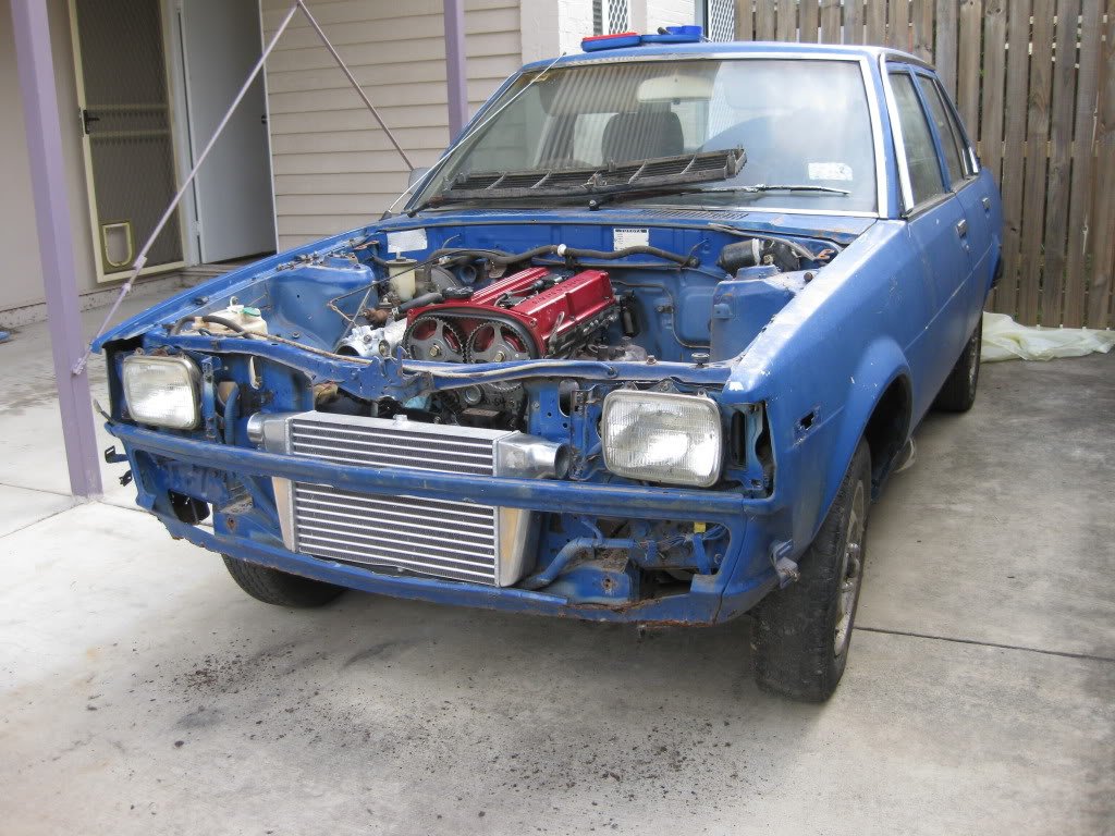

Today's efforts gave me a chance to see how well the motor will sit in the engine would fit in the corolla. So far it looks good with only the oil filter sitting a bit close to the sway bar. The engine plates i made up line up really well with the crossmember and good clearance both sides and at the back of the motor.
