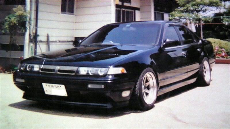

    i love that you're going 15s, i love the you stayed NA and went ITB, i love that you're doing everything i would do to a ceffy.
    here's a pic to keep you motivated
