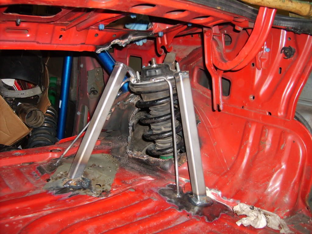

but yeh. if your doing 32 fonts.. will you not need to weld new towers in the rear to accomidate for the top mounts.
this is entirely unsubstantiated, BUT i have heard and yet to see any reason it work... apparently fc rear coilovers are quite a good fit, just need some slotting of the top hole? they are also quite a heavy car so the valing is quite hard.... and can be had pretty cheap.

i will be doing coil over sleeves that will fit most normal rear shox soon. as well as a spacer to space the spring hat away from the body enough that you shouldnt need any mods to the shock tower at all.

slydar, I was going to do exactly what your suggesting but i have been warned that the shock housing would not be able to handle all the extra stress unless its made for that like the sylvia/skyline type struts. WHat do you make of that?
