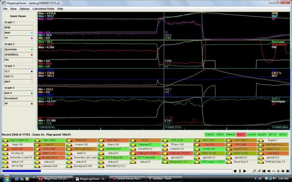

    So, here's a datalog of an evo'ish car, running a 4g63.
    Look at graph 1 logging throttle position, RPM, and boost. After flooring from cruise it goes from 70kpa to 160kpa/9psi in less than a second. That's at only 3000rpm, and boost tops out at wastegate pressure of 14psi on the graph. Dude reckons it does 24psi by 4400rpm but I KNOW that amount of boost can be brought on sooner. Turbo's about the same size as a GT35 so it'll crack 300rwkw on a 2l for sure and with not much lag at all.
