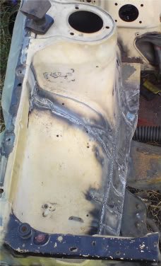

    I found that out the other day meadan, if it isn't to much hassle I'll give it a go, but it's not likely.
    A bit more welding and grinding, and then this side is done. all in good time.

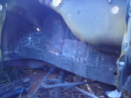

    Thanks for the comments sam, I am really unsure on how to do the front suspension, I am not changing the crossmember though, the engine works really well with the 86 cross member, the rack is in a perfect spot, and the sump will require minimal modification. I have been eyeing off the cressy front end, which I am fairly sure, is similar or the same as 61 gear, but I don't think I could bring myself to doing it to cressy.
    I'll get some more pics up later, radiator is sorta kinda mounted, need to see what I am to do with a fuel tank before its finalised, pretty cool though, vents out of the number plate spot. One more piece of steel to go it on the drivers side (just a small piece), then on to the passenger side, which is slightly different in design, due to the offset heads.
