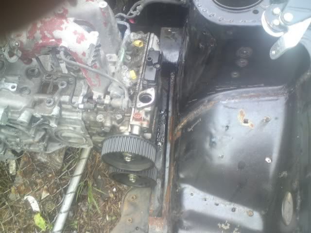

    looking at that, only a tiny amount of rail needs to be removed hahaha, whoops, guess the next shell will be a bit better.

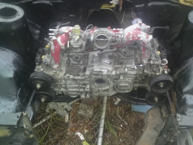

    Pulled the engine down today, obviously, but I am thinking it has had a rebuild, although the bores are fairly average (read gunky) but the decks, plug vallies, water jackets, are all immaculate, it had aftermarket 1.3mm head gaskets, and there is evidence the oil pump, and water pump have been removed. So I am thinking a dropped valve, and something has gone through the turbo, which would be why it is in such good condition. Shame I will be rebuilding it again.

    dropped a valve pah! how the stupid thing is horizontal

    are you gonna run the spider manifold backwards with the throttle body facing forwards? you will need to relocate the alternator to where the AC normally would be.
  7. #327
    Gunner
    yep, just flip it over, and fabricate a bracket, its a pretty easy thing to do. But I might set it up so it runs two belts instead of one, and then I can use the AC tensioner.

    i think the engine is on it's side gunner.
    amateur mistake etc bla bla bla
  10. #330
    Gunner
    shit i didnt realise, thanks for pointing that out toddy.
