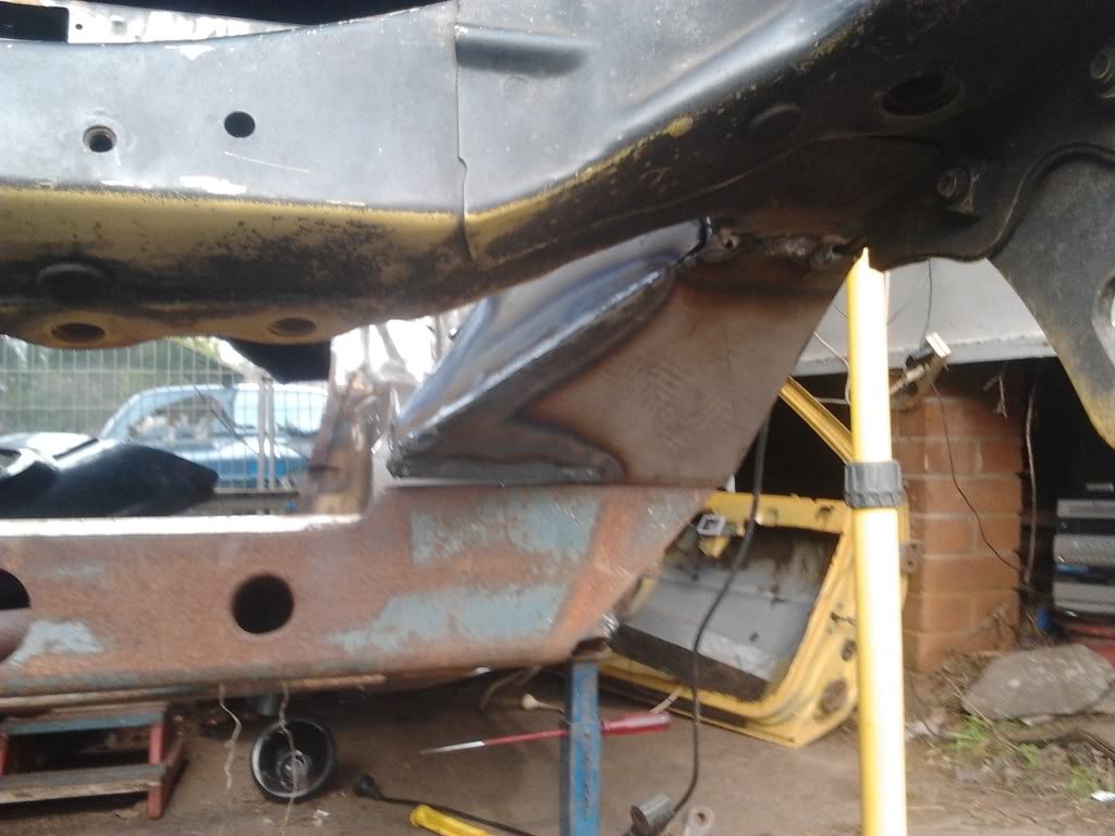

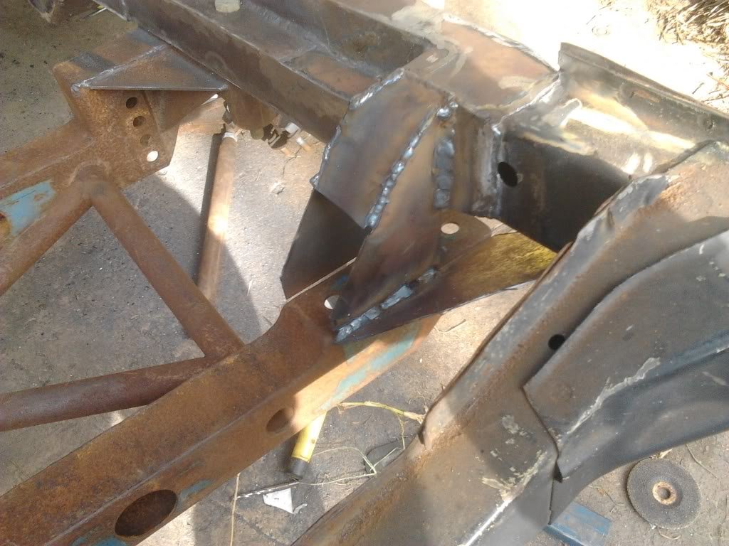

    Rails are done, need to make caster mounts though

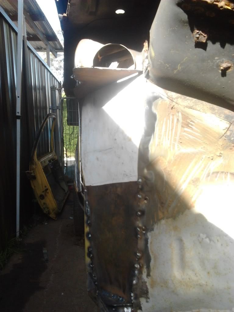

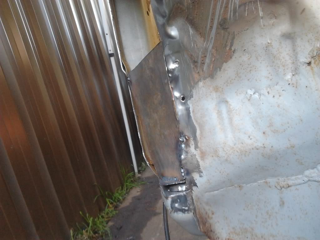

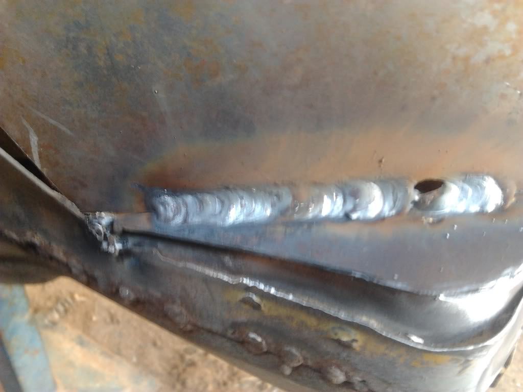

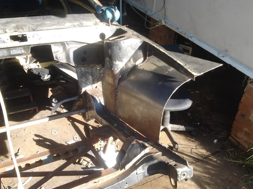

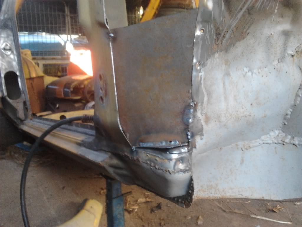

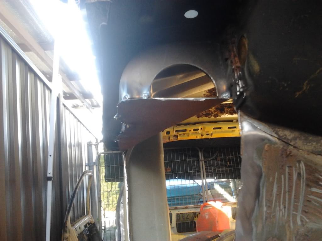

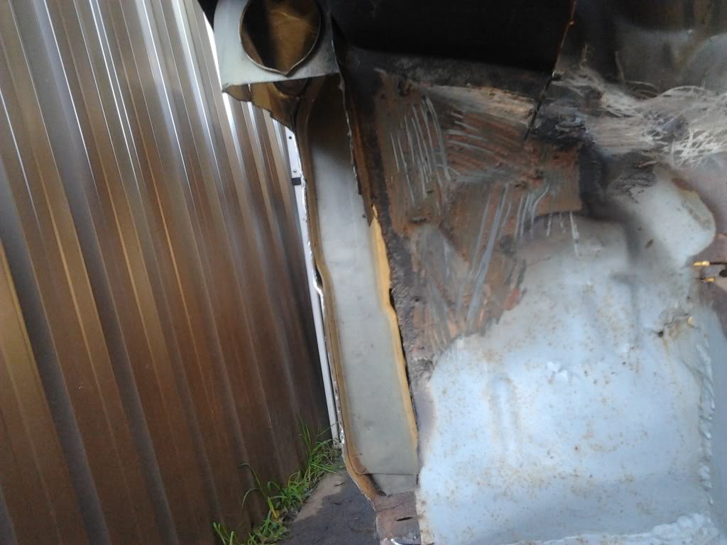

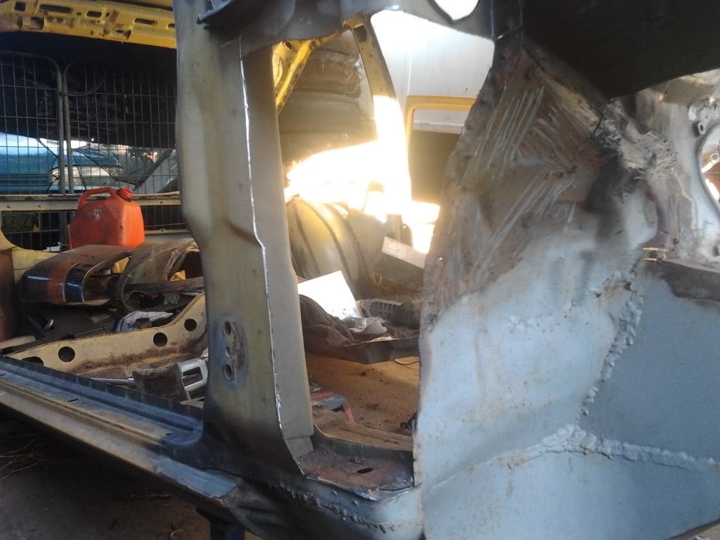

    Decided I wanted to do something other than structural work this morning, (Im out of 1.6 sheet) so I began working on my first aero mod. Air extraction from the front wheel wells. Hopefully it will work well.
    My welding is 100% on what it used to be lol
    well there you go, have fuck all gas, so final.welding can wait.

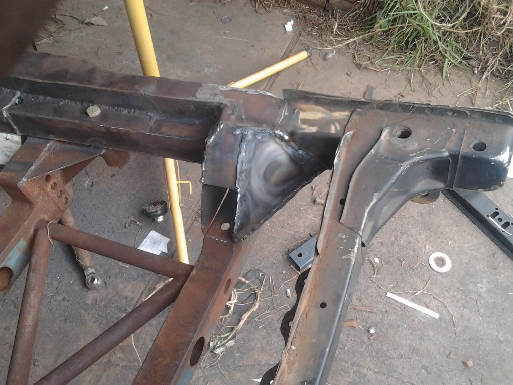

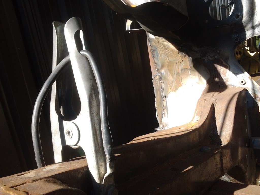

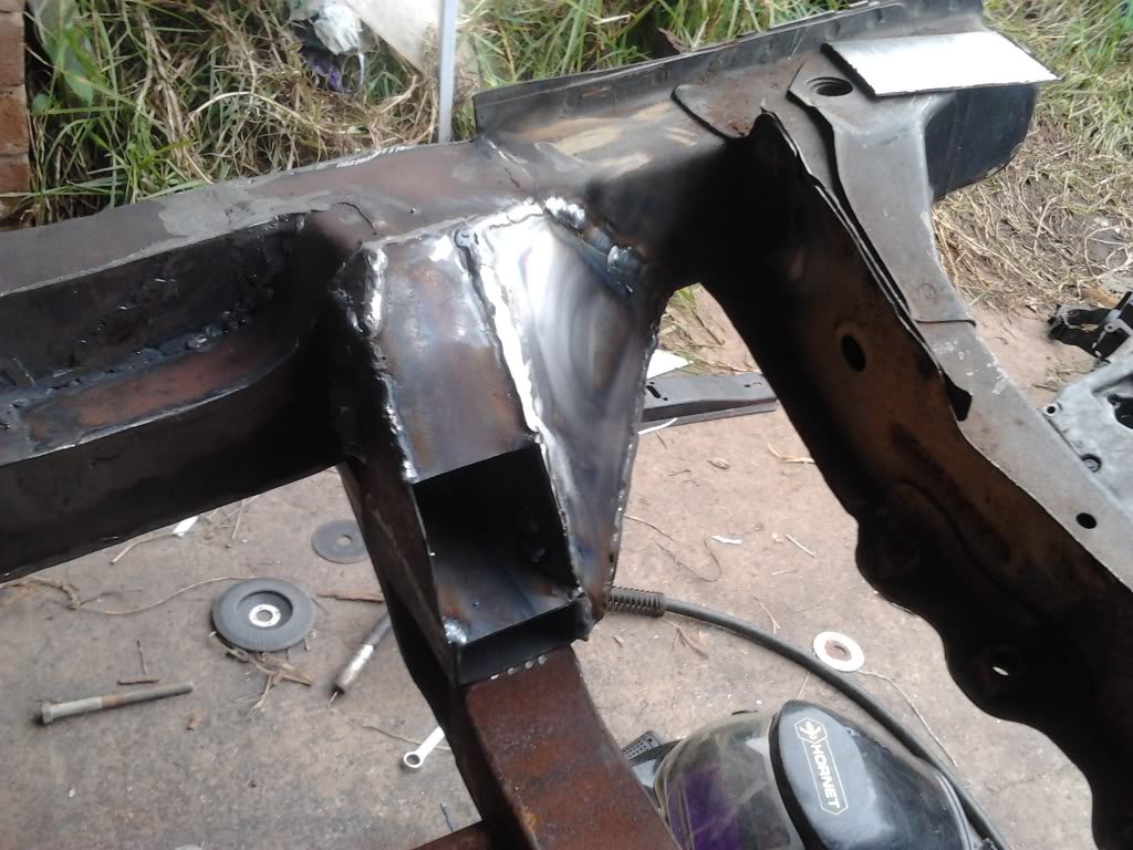

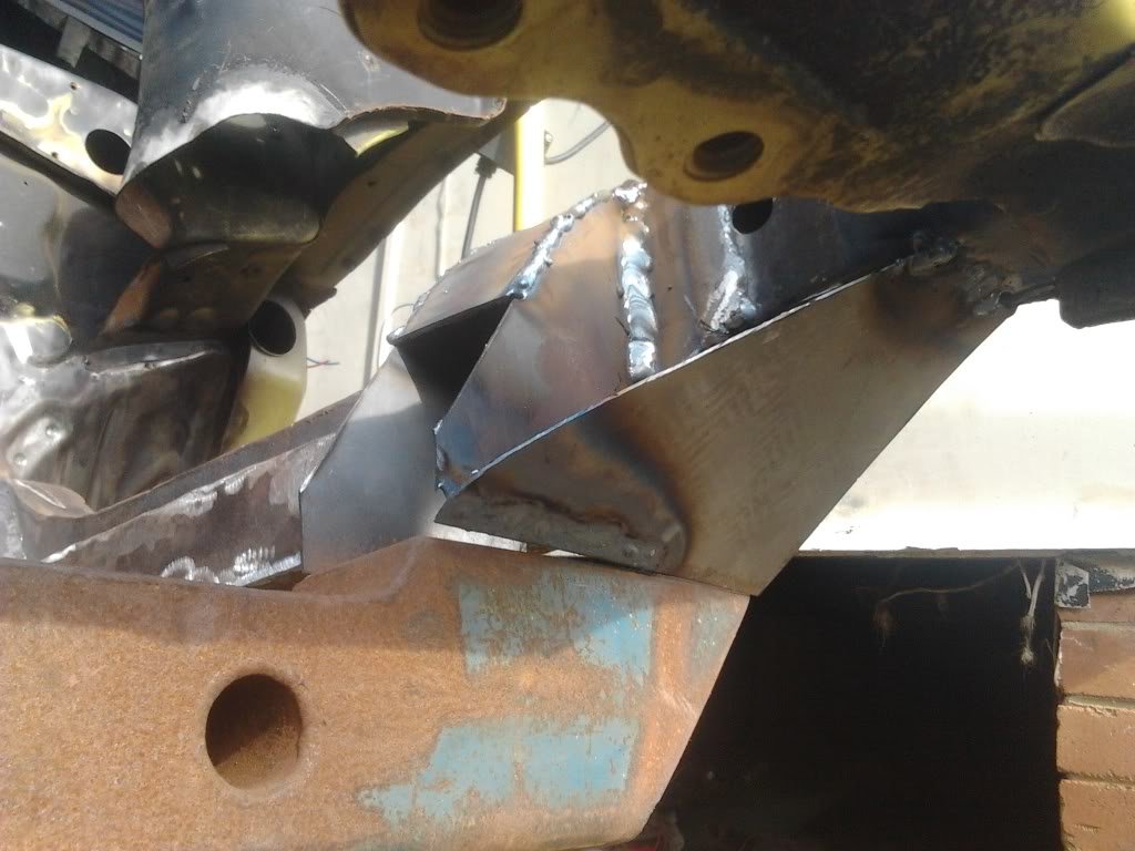

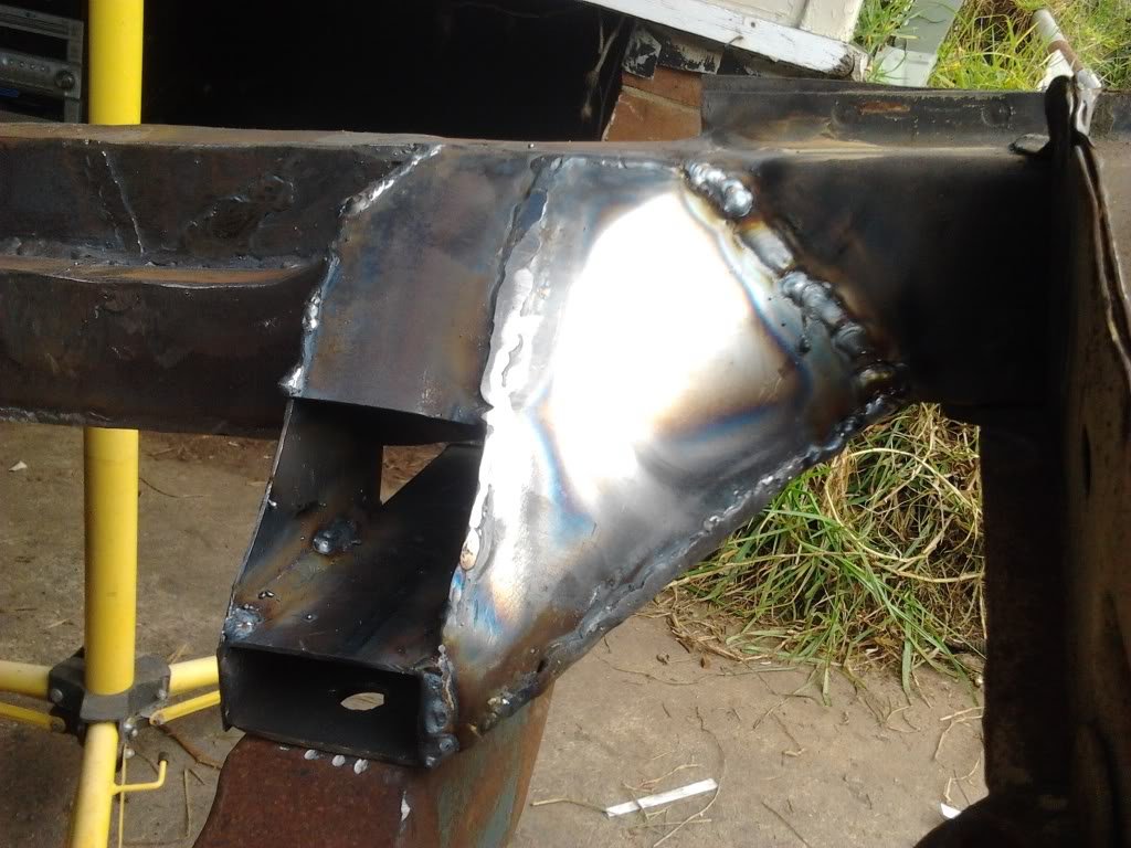

    Did some work on the caster/subframe jiggas this morning. Probably a bit of overkill but meh, what ya gonna do.

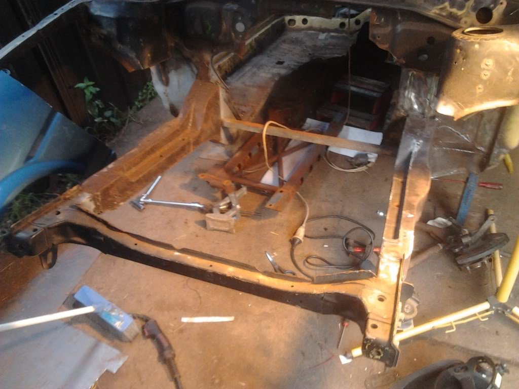

    are you still fully welding everywhere?

    Yeah Adan, in the rails any way, I know itll be prone to cracking, but without beong able to fold edges and stuff, I dont know of any other option Id be confident with.I suppose it shows my inexperience, but Im not rebuilding ot again lol.

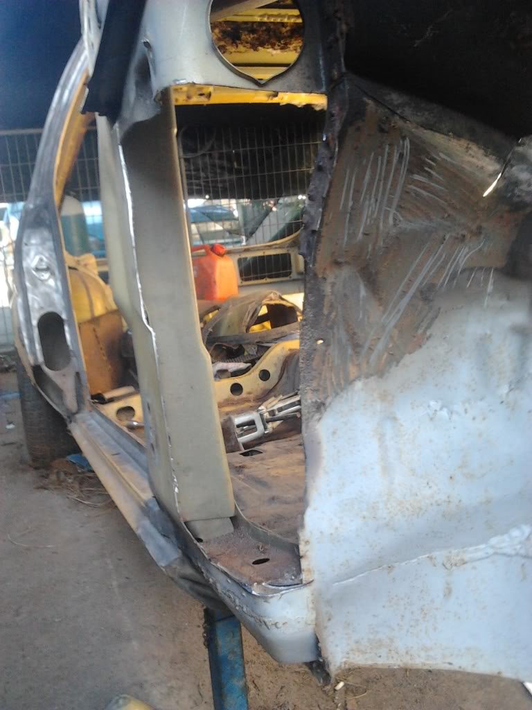

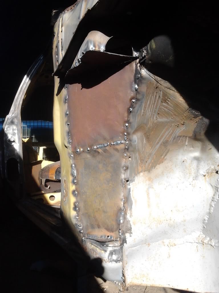

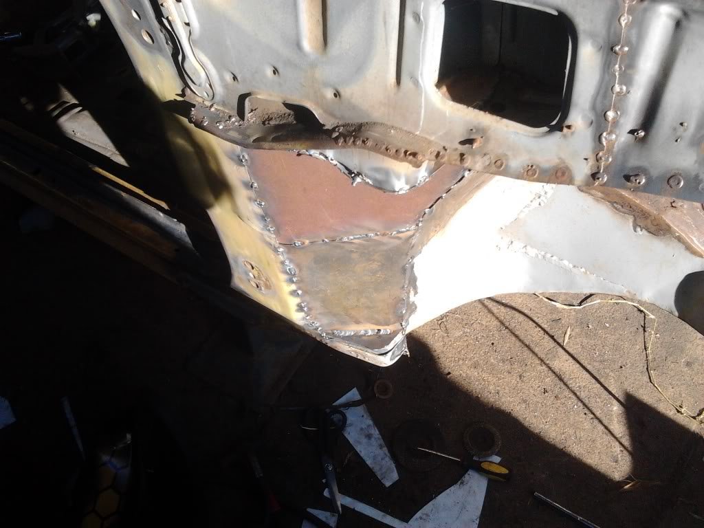

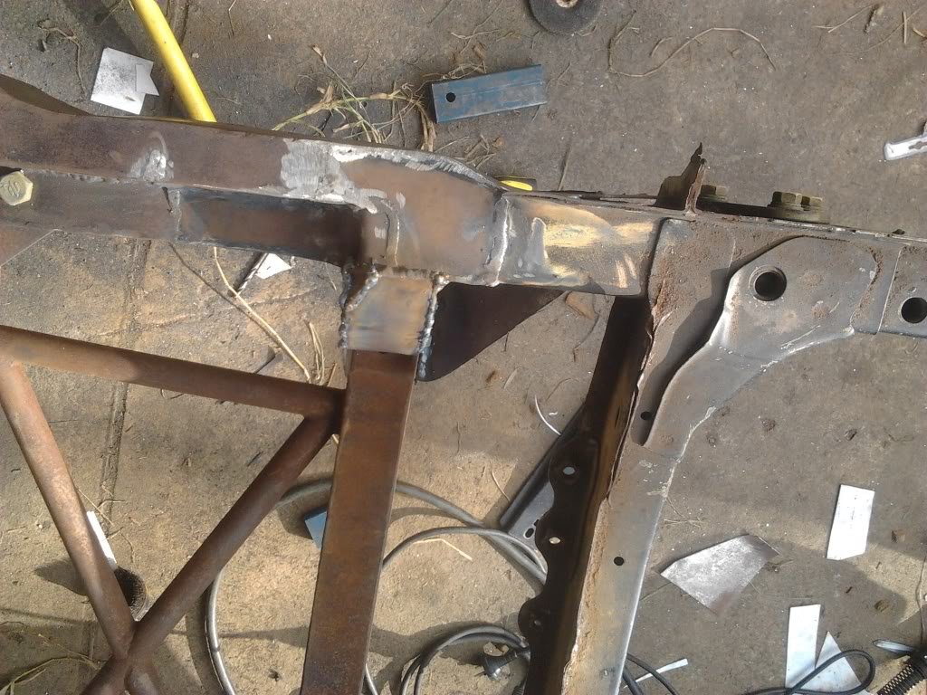

    More progress, but its wrong so I have to do it again. Out of gas too so that doesnt help, anyway...
    That should give you an idea of whats happening. And yes Adan all this will be stitched, 20mm @ 30mm intervals.
