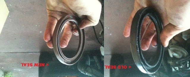

    Not a great pic, but the dark blue circular seal around the crank is the main seal. May need to take off backing plate if you havent already
    Undo the 6 bolts and undo the nuts holding the sump on until the sump bolt holes at the back clear the studs,
    Then pry off the aluminium seal housing, flip it around, wack the old seal out, put new one in
